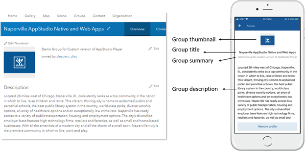

Step 1. Create a group in ArcGIS Online or Enterprise
Sign in to your ArcGIS organizational account and create a group. Then provide title, thumbnail, summary, and description to the group. These contents will be displayed in the custom profile About page

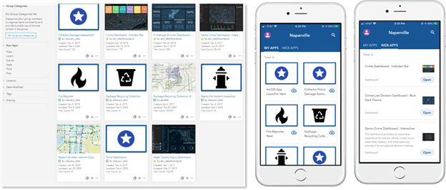

Step 2. Share AppStudio native apps and web apps
Select the AppStudio native apps and web maps that you would like to be displayed in the Player and share them with the group created from step 1.

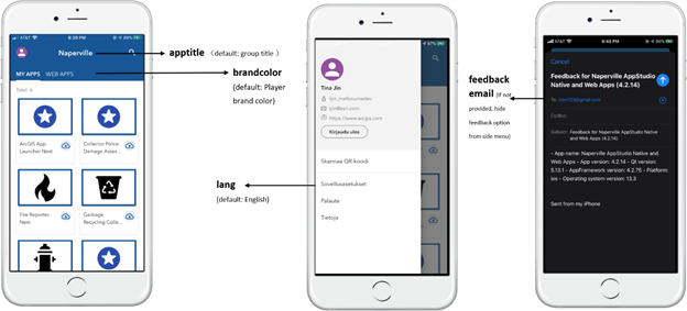

Step 3. Add tags for the group
You can add tags in the group to configure AppStudio Player. As of AppStudio 4.2 release, we support the following four tags:
- brandcolor:6e2f2f (Player branding color, the value is the hex code of the color)
- apptitle:Naperville (Text on the app header)
- feedbackemail:1234John@gmail.com (Feedback email address)
- lang:en (Player language, the value is the four-letter LCID string language code)
Note: please replace the value with your own AppStudio Player supported languages

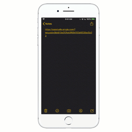

Step 4. Create a Player link
You can now create a link that will launch Player with your custom profile on either iOS and Android. This allows you to immediately open and pass specified content (parameters) from the link to the app. Follow the below format to create a Player link that includes the group ID.
https://appstudio.arcgis.com?groupid=<enter-group-id-here>
i.e. https://appstudio.arcgis.com?groupid=9bb613e2f3fa48f694163e9538ac5a33

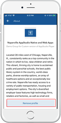

Step 5. Launch Player with the custom profile
The last step is to send the Player link to your mobile device and tap on it to launch the Player with the custom profile. If you want to remove the custom profile, you can tap on the menu > About page > Remove profile button
