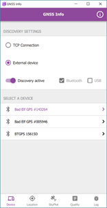

Receiver detection
This app can detect receivers that are connected to your device using:
- Bluetooth pairing – to connect to a receiver in your app you must first pair it with your device. Note that some receivers have a limit to the number of devices they can be paired to at anyone time. For example, the Eos Arrow can only pair to one device at a time, while Bad Elf devices can pair with up to 2 devices at a time. For information on pairing your reciever see Use a high-accuracy GPS receiver—AppStudio for ArcGIS | ArcGIS .
- USB/COM connection – A GPS receiver that plugs into a computer via USB is displayed in the app as a COM port. To confirm which COM port your device is represented by, look at the list of devices connected to your computer. For example, on Windows go to Device Manager > Ports (COM & LPT).
- TCP/UDP network connection – A TCP (Transmission Control Protocol) connection is bidirectional and has limited error handling. On the other hand, UDP (User Datagram Protocol) is one way only and has no error handling. Creation of a UDP connection requires the hostname and port of the destination machine (where you are running the app), while creation of a TCP connection requires the hostname and port of the machine providing the GNSS information to the destination machine.
On the device tab, press to select a device. Next time you launch the GNSS Info app, it will attempt to automatically connect to the last device used. You can always return to the device tab and change which device you connect to.

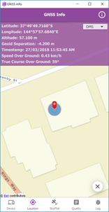

Location display
The location tab shows the current location on a map. If your device has network connectivity, an online basemap is used. A limited offline basemap is also available in the sample.
Key metadata about the current location is displayed. The app also allows the user to change the units in which latitude and longitude are displayed.
Use the location tab to confirm that the location reported from your hardware is the expected location.

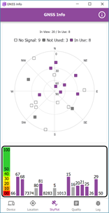

Satellite sky plot
The skyplot tab shows both a skyplot and a table view of the satellites reported by the receiver. Be aware that some receivers have a physical display that may sometimes display different values to this page. Other receivers have their own companion app that also may show different results. These differences are mostly likely attributed to manufacturer specific parameters and the way each manufacturer presents data from the receiver.
The GNSS Info app displays the number of satellites in view, and the amount in use to calculate your location. There can also be satellites in view (or in use) that have no signal. This is usually a temporary response and should not affect the quality of a location displayed in an app.
Use the skyplot tab to ensure you have positioned yourself or your hardware in the best location to capture a suitable position value.

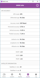

Quality tab
The quality tab lists common meta data available from a GNSS receiver. These are values you may choose to capture during data collection as attributes of your feature. Alternatively, you may use these to indicate the quality of the position to the user. For example, you might warn the user that accuracy values are greater than a prescribed threshold and disallow them to capture data.

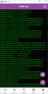

Log tab
The log tab shows a stream of the sentences that are emitted from the receiver. Different receivers output different sent
ences. The presence or absence alone of sentences is useful for troubleshooting a receiver connection issue. The inspe
ction of the presence or absence of individual sentences can also aid diagnosis of unexpected parameter results. For example, latitude, longitude and altitude errors are only calculated when the GST sentence is present. Not all receivers
output the GST sentence. If the GST sentence is not available, then ‘No Data’ is reported on the quality tab for latitude, longitude and altitude error.
Use the pause button on this tab to study the latest sentences. Use the delete button to clear the screen to make it easier to read new sentences.
