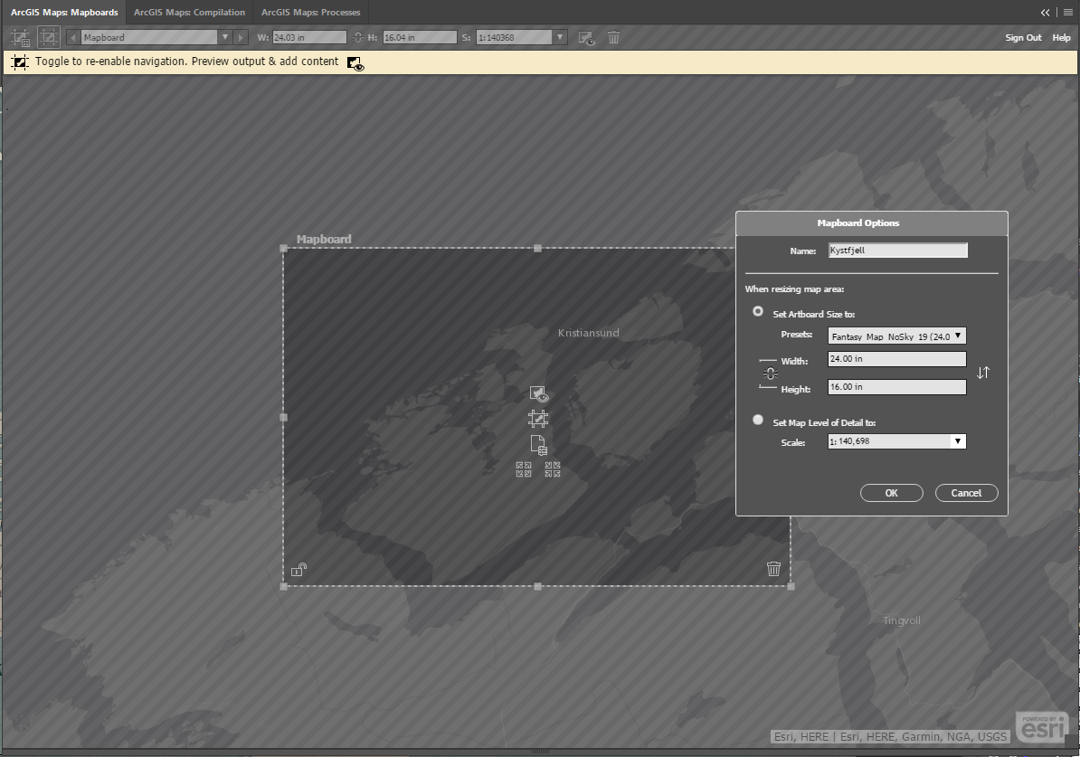

The M4CC app makes mapping really easy, even for graphic designers who have never before made a map. Like a lot of mapping software, how you use it depends on the map you are trying to make. With the M4CC app, the first step in actually building the map is to draw a mapboard. A mapboard is the area that you are mapping, which will download into your Artboard in Illustrator. So, if you're building your mapboard as an 11x17-inch tabloid over Peru, your downloaded map will have an 11x17-inch Artboard in Illustrator. But, you could also use what Esri calls a webmap to build your map, in which case you can allow that webmap to inform your mapboard's size. For more info about using a webmap in M4CC, watch this video on the new features in the 1.2 version.
Mapboard Window
For my mapboard, I used the Mapboards tab to zoom into the coastal area of Kristiansund, Norway. One of the new features in the 1.2 version of M4CC is the ability to choose preset mapboard sizes. This is really useful when you're making a map to fit a specific area. I did not use the presets for my Kystfjell map, but instead used a custom 16x24-inch size and also selected to increase the level of map detail.
Note: Increasing map scale will also increase your map download time.
Defining the map area for Kystfjell

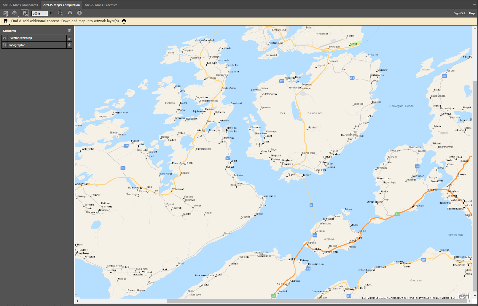

After defining my map area, I needed to add data to my map in the Compilation window. By "data" I mean vector and raster map layers that will be converted into editable artwork in Illustrator. My approach for finding the right map data for Kystfjell was pretty exploratory, but I also wanted to use the VectorStreetMap available for free to M4CC users. This is a rich collection of roads, cities, parks, waterbodies, and many other things that can be used to make a map. You can find it in the Compilation Window's Search and Add Layers when browsing from Maps for Creative Cloud.
Loads of Vector Data
VectorStreetMap data added to the Kystfjell mapboard in the Compilation window
Now that I added the VectorStreetMap data, I used the Search and Add Layers to explore more layers that were available in this region of the world. When adding data to the Compilation window as you're building your maps, in addition to the Maps for Creative Cloud layers, you can also browse available map data on ArcGIS Online and Esri's Living Atlas of the World. The coolest part about searching for map layers with the M4CC app is that you can find these map layers while never leaving Illustrator. If you are part of an ArcGIS Online organization, you can also host and add data from there as well. Check out this page to learn more about adding data to the Compilation window.
After I added what I felt was sufficient data for designing a my map, I downloaded it into Illustrator, by clicking the Sync button at the top of the Compilation window.

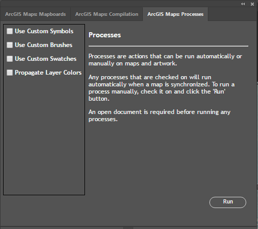

For my Kystfjell map, I did not take advantage of the useful processes in the Processes window, which is the third and final tab of the M4CC app. Briefly, the Processes window is a place to set up the M4CC app to automatically apply your own custom swatch, brush, and symbol libraries to your map as it downloads! You can also use the Processes window to customize your symbology automatically, after you've downloaded the map as well.

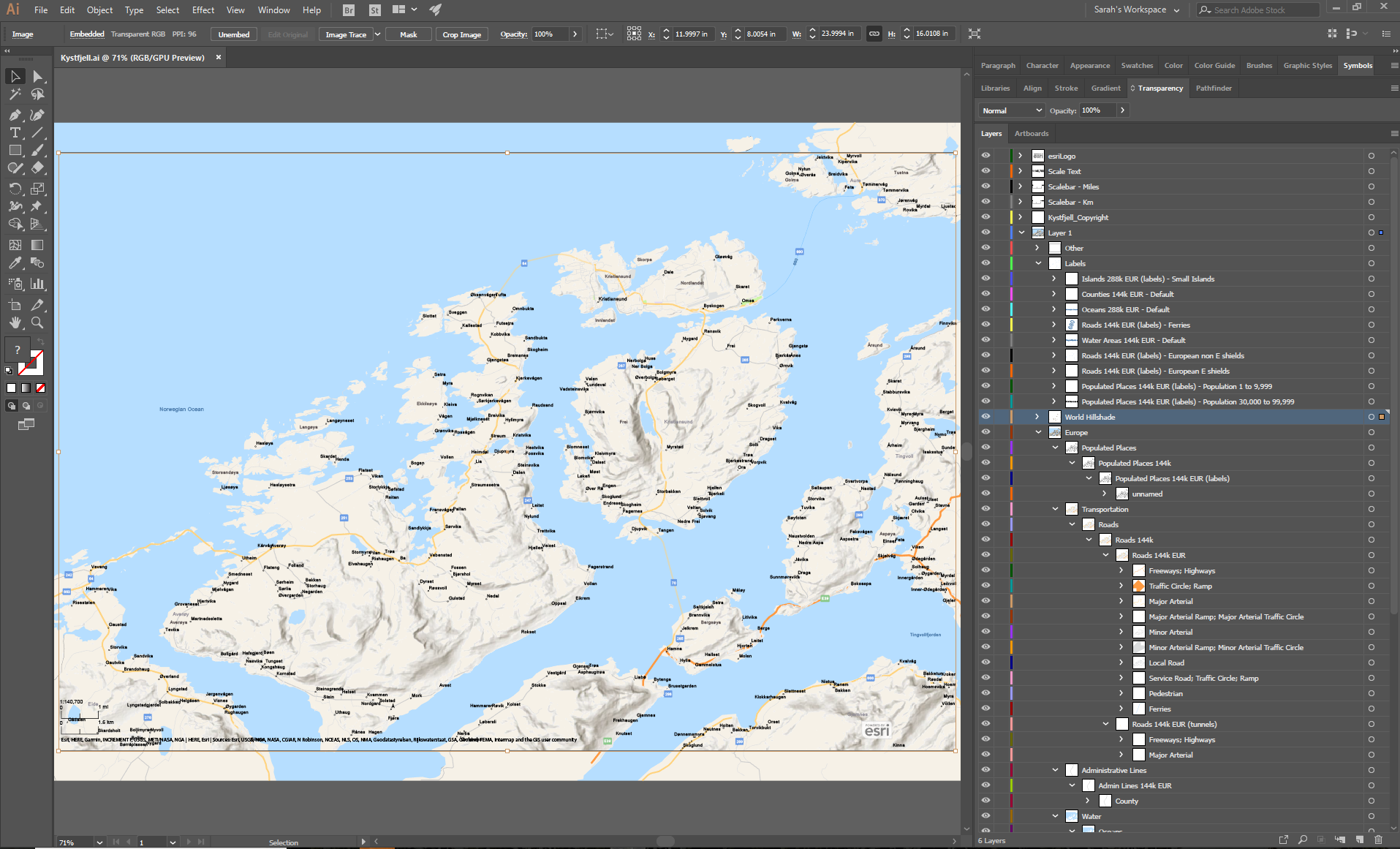

The downloaded map prior to designing it
The image above shows basically what the Kystfjell map looked like in Illustrator before I started styling it. Notice that it has a convenient organized layer structure. All the city points are in one layer, and all the city labels are in their own layer as well. In fact, every data type has its own layer. This makes it really easy to get started on styling any map that you're making. Maps downloaded with the Maps for Creative Cloud extension also come with a layer of data source credits, so you don't have to spend time tracking down that information. Check out Part II, where I show which land I kept, which I moved, and which I removed to make this fantasy map.
