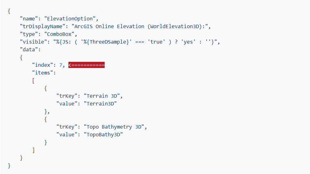

The issue is the same for all the templates. There's a section in the wizard.json file that references an invalid index.
If you change that value to 0 or 1 it will fix the issue. If you've already run the post installer then the templates will be installed on your system. For example, on Windows, the templates are found in this path:
