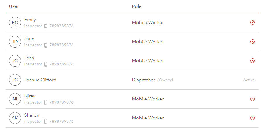

Once this script has been run, check that your tree inspectors have been successfully added to your project (shown below).

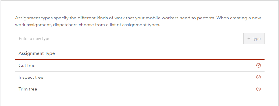

Add assignment types
Note: We will be using Jupyter notebooks to complete the remaining tasks within this workflow. Notebooks are useful for visualizing data and running code step by step. Either open a blank Jupyter Notebook or follow along with the notebook you downloaded earlier.
First, import the ArcGIS API for Python library.
Next, connect to your GIS and fetch the project using its feature service item ID or project ID.
Once this set-up is complete, you can start performing tasks specific to your project. You’ll first want to add assignment types to the project that are relevant to tree inspections.
After you run this code, you can check that the assignment types have been successfully added to the project (shown below).

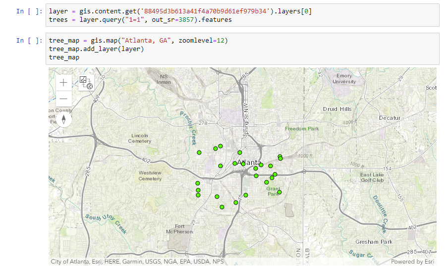

The city of Atlanta has provided a feature layer containing the trees that are at risk of falling. Using the Python API, you can create an inspection assignment for each feature within this layer.
First, import the datetime library. Datetime allows us to pass the current time into the assigned date field.
Then you can fetch the layer containing the trees, query it, and display it on a map.
Workforce stores assignments in the WGS84 Web Mercator projected coordinate system, so let’s ensure that the returned geometries are using this spatial reference.
Here is the item ID for the trees feature layer: 88495d3b613a41f4a70b9d61ef979b34
The Atlanta Trees layer is displayed.

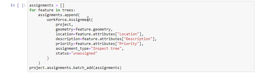

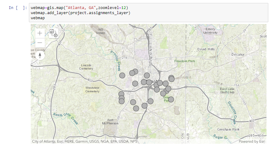

Now you will create 24 “Inspect tree” assignments: one for each tree. You will loop through the trees feature layer to batch add assignments using the “Inspect tree” type we created in the previous section.
To ensure that a new assignment was created for each tree, display the assignments layer on a map.
Your project now has 24 tree inspection assignments.

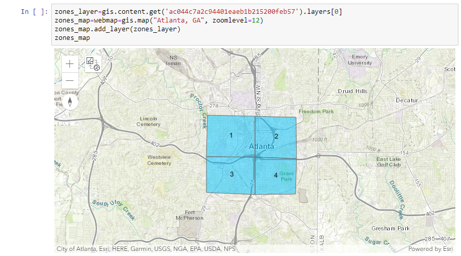

Next, let’s get the Inspection Zones feature layer and display it on a map.
Here is the item ID for the Inspection Zones feature layer: ac044c7a2c94401eaeb1b215200feb57

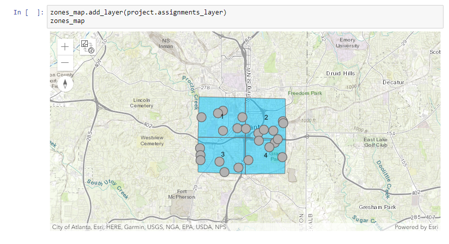

Add your assignments layer to the map so you can visualize how the assignments are distributed within the zones.

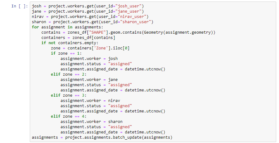

Next, you’ll create a spatially enabled data frame from the zones layer and grab all of the unassigned assignments.
Assign tree inspections to workers within each of their respective zones.
- Trees in Zone 1 should be assigned to Josh
- Trees in Zone 2 should be assigned to Jane
- Trees in Zone 3 should be assigned to Nirav
- Trees in Zone 4 should be assigned to Sharon
The following code will assign each worker to the trees that fall within the work zone they are responsible for.

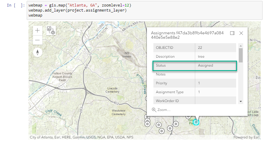

Run this code and then create a map with the updated assignments layer to make sure everything was assigned properly. If you click on any of the features, the status should read “Assigned”.

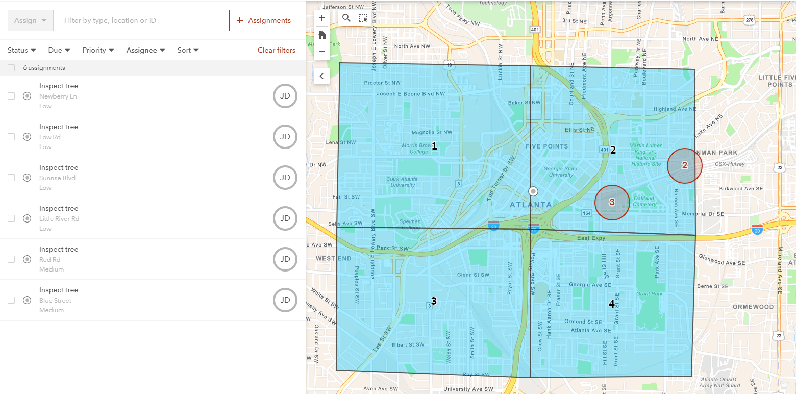

Now, if you open your Workforce project, you can view all of your updated assignments. If you sort by assignee, you’ll see that inspectors were only assigned to work for their specific zone. You’ll see that only inspections in Zone 2 were assigned to Jane.
