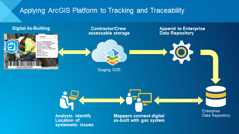

The ArcGIS deployment pattern for Tracking and Traceability is comprised of four steps, as illustrated here:
Step 1: Digital as-builting
The recent improvements to Collector have made this process easier than it was just a few years ago. The first enhancement was the revamping of the interface to simplify data entry. The second enhancement was to increase the certification of GPS vendors and their devices. Here is a link to the list of GPS receivers which can be used with Collector: https://doc.arcgis.com/en/collector/ipad/help/high-accuracy-prep.htm
The third enhancement is the native ability of Collector to use the mobile device’s camera to capture the ASTM F2897 barcode.
With these enhancements, field staff can go into the field and capture the as-built information of the new construction using a smart device running Collector. The smart device is Bluetooth-connected to a high precision GPS antenna. The field staff use the high accuracy GPS antenna to capture the location of the newly installed assets. The collected location data is directly streamed into Collector as native ArcGIS features. No translation or conversation is required. The field staff then manually input into Collector a minimal amount of information, such as Installation Date, and installation method. The field staff then uses the device’s camera to capture the barcode and automatically populate the BARCODE attribute of the GIS feature. The BARCODE value contains information about the asset, such as size, material, manufacturer and manufacture date. Once the BARCODE value is captured, the field staff no longer need to manually enter this information.
The recent enhancement to Collector supporting the ability to run arcade scripts in the pop-up window, provides the ability to immediately display the decoded data to the field staff even when the device is disconnected.
An additional capability of an Esri mobile app on a smart device or tablet is the ability to capture photos of the newly installed assets. These photos are automatically associated to the GIS feature.
When the field staff have completed the collection of the newly installed assets, the GIS features are submitted to the staging geodatabase.
Step 2: Contractor/crew assessable storage
A fundamental challenge of Tracking and Traceability is how to correctly integrate high precision GPS geospatial data, with less accurate legacy geospatial data. A key component to overcoming this challenge is the staging geodatabase. A staging geodatabase can be either hosted in ArcGIS Online as hosted feature layers or stored on premise with a local ArcGIS Enterprise implementation. The key purpose of the staging geodatabase is to provide an easily accessible data repository for the field crews to submit their collected construction information too. The staging geodatabase only holds the newly collected construction information. The construction data sits in the staging geodatabase until a mapping professional using ArcGIS Desktop accesses and downloads it to the enterprise geodatabase.
With the new enterprise geodatabase capability of attribute rules, it is possible to have the captured barcode value automatically read and used to auto-populate the derived attributes manufacturer, lot number, production date, model, material, diameter, and wall thickness. If the digital as-builting described in step 1 happens while the device is connected to the enterprise geodatabase, then Collector will automatically decode the barcode, auto-populate the derived attributes and display the decoded information immediately after the new/updated GIS feature is submitted by Collector. In the second blog, we will provide links to these arcade scripts and describe how to apply them to an enterprise geodatabase.
Step 3: Append to enterprise geodatabase
One of the time saving capabilities of ArcGIS Desktop is the ability to interact with data from both the staging geodatabase and the enterprise geodatabase at the same time. This allows the mapping professional to easily select the staging geodatabase features and append them into the final enterprise geodatabase feature classes.
If the staging geodatabase layers are stored in ArcGIS Online, the previously described attribute rule arcade scripts can be applied to enterprise geodatabase layers.
NOTE: Attribute rules only work with ArcGIS Enterprise 10.7 or higher. Additionally, ArcGIS Pro is the only desktop tool to understand attribute rules. If using ArcMap and a geometric network, it is important that the staging geodatabase layers be stored in an enterprise geodatabase and the attribute rules are applied to the staging geodatabase layers.
The standard arctoolbox geoprocessing append tool can be used to copy the newly collected GIS features from the staging geodatabase layers to the final enterprise geodatabase feature classes.
Step 4: Mappers connect digital as-built with gas system
With the new construction data now appended from the staging geodatabase into the enterprise geodatabase and the barcode value decoded, the mapping professional now needs to determine how to connect the high precision geospatial features with the less accurate geospatial features. The outcome of this process needs to honor two data requirements:
- Connecting the new features with the legacy features to create a single topologically connected gas pipe system.
- Preserving the high precision GPS collected geospatial coordinate data.
The recommended best practice for accomplishing this seemingly disparate set of requirements is for the enterprise geodatabase point features such as Meters, Excess Flow Valves, and Non-Controllable Fittings to have the following attributes added: SPATIALACCURACY, GPSX, GPSY, GPSZ. Here is another example where attribute rules can streamline the population of these GPS fields. If using ArcMap and the geometric network, then a configuration of Esri’s Attribute Assistant tool or ArcFM’s AutoUpdater capability can be used to automatically populate these fields. This will preserve the original GPS location values, which can be used later to rubbersheet all features (legacy and GPS) to the more accurate GPS location preserved in the GPSX, GPSY, and GPSZ attributes. With the GPS location preserved, the mapper can adjust the new construction features as required to connect to the legacy gas pipe system.
