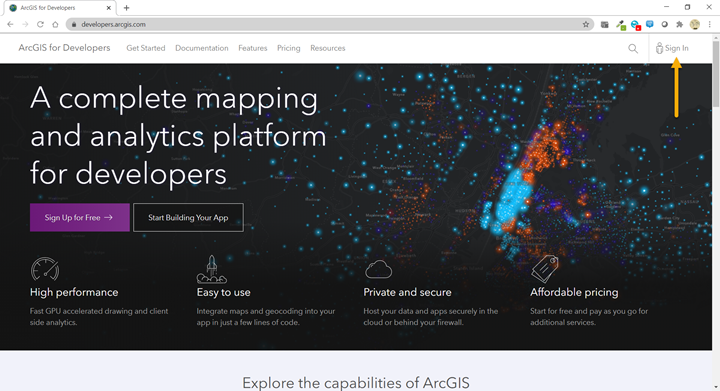

- Log in to developers.arcgis.com with your ArcGIS Online credentials

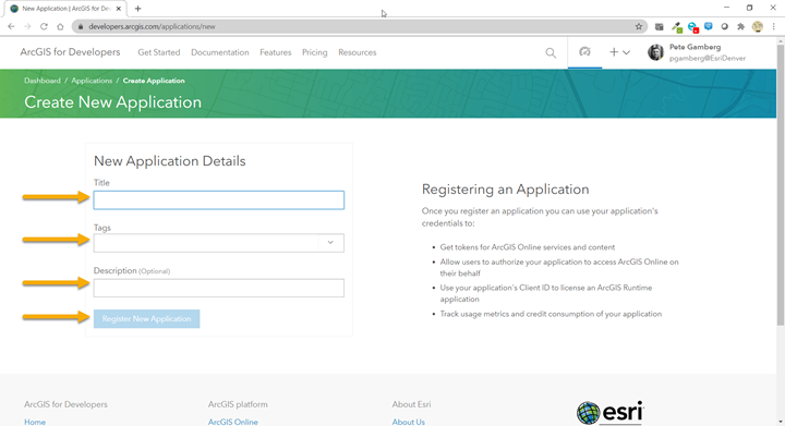

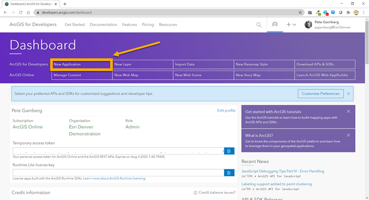

- Register your application by choosing New Application
- Provide the Application Details

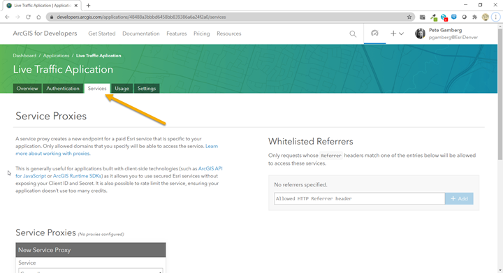

- Click on the Services Tab

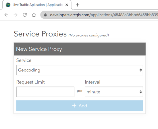

- Scroll down to the Service Proxies area.

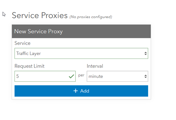

- Select the service you wish to proxy and enter a rate limit for the number of requests you want to allow over a given period.
- Copy the newly created proxy URL and add it to the webmap that your application is consuming. Remove the original service if it exists and save the webmap.
