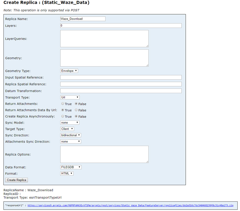

I can also successfully download a file geodatabase using the createReplica endpoint via REST:
However, if I want to apply a WHERE clause, I am having some problems getting the layerQueries parameter to work via REST
<SPAN class="punctuation token">{</SPAN><SPAN class="string token">"0"</SPAN><SPAN class="punctuation token">:</SPAN><SPAN class="punctuation token">{</SPAN><SPAN class="string token">"queryOption"</SPAN><SPAN class="punctuation token">:</SPAN> <SPAN class="string token">"useFilter"</SPAN><SPAN class="punctuation token">,</SPAN> <SPAN class="string token">"where"</SPAN><SPAN class="punctuation token">:</SPAN> <SPAN class="string token">"type = JAM"</SPAN><SPAN class="punctuation token">,</SPAN> <SPAN class="string token">"useGeometry"</SPAN><SPAN class="punctuation token">:</SPAN> false<SPAN class="punctuation token">}</SPAN><SPAN class="punctuation token">}</SPAN>
<SPAN class="punctuation token">{</SPAN><SPAN class="string token">"0"</SPAN><SPAN class="punctuation token">:</SPAN><SPAN class="punctuation token">{</SPAN><SPAN class="string token">"where"</SPAN><SPAN class="punctuation token">:</SPAN> <SPAN class="string token">"type = JAM"</SPAN><SPAN class="punctuation token">}</SPAN><SPAN class="punctuation token">}</SPAN><SPAN class="line-numbers-rows"><SPAN></SPAN><SPAN></SPAN><SPAN></SPAN></SPAN>Both of the above result in:
Exporting data for layer 0 failed.
Can anyone point out what is wrong with my layerQueries param, I am sure it must be something simple.
