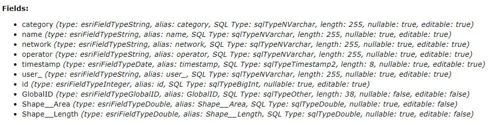

1. I get the necessary information for the new Feature Layer form the existing one (fields, geometry type and name). This information is stored in a dictionary with the correct key as they are required in the layer description. The "Shape_length", "Shape_area" and "FID" fields are removed.

dictLayer<SPAN class="punctuation token">[</SPAN><SPAN class="string token">"name"</SPAN><SPAN class="punctuation token">]</SPAN> <SPAN class="operator token">=</SPAN> existingLayer<SPAN class="punctuation token">.</SPAN>properties<SPAN class="punctuation token">[</SPAN><SPAN class="string token">"name"</SPAN><SPAN class="punctuation token">]</SPAN><SPAN class="line-numbers-rows"><SPAN></SPAN><SPAN></SPAN><SPAN></SPAN><SPAN></SPAN></SPAN>2. The dictionary is appended to a list and a dictionary is built out of this. This dictionary is used to update the layer's definition. This works very well and the layer with the fields occures in ArcGIS Online.

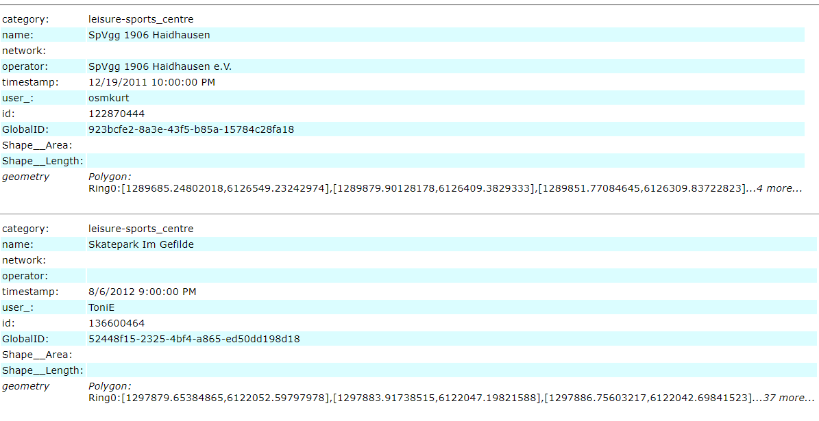

When I swith to the "Data" tab in ArcGIS Online there is a number of Features but no entry in the Table view.
