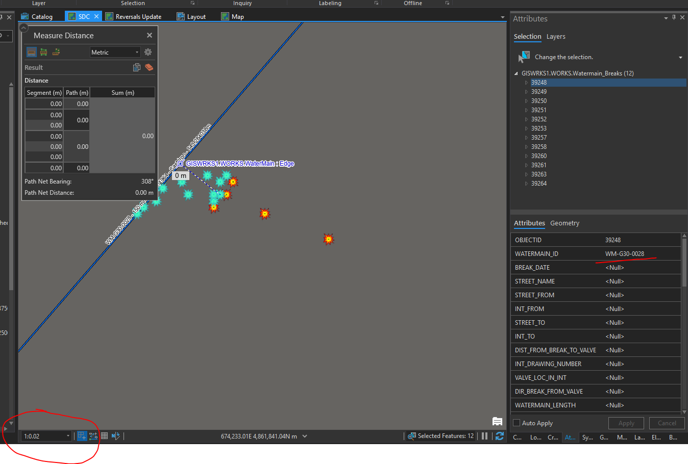

How close do two object have to be in order for a SpatialFilter Intersect considers them to be intersecting? I'm doing some testing at a very small scale and getting some 'not expected' results.
In the screenshot below, I am running the following code to find the intersecting Watermain ID to place onto the Watermain Break point. So basically I pass the point of the selected Watermain Break and the Watermain Layer to this procedure (GetIntersectingFeature), and then update the Watermain Break:

<SPAN class="punctuation token">}</SPAN><SPAN class="line-numbers-rows"><SPAN></SPAN><SPAN></SPAN><SPAN></SPAN><SPAN></SPAN><SPAN></SPAN><SPAN></SPAN><SPAN></SPAN><SPAN></SPAN><SPAN></SPAN><SPAN></SPAN><SPAN></SPAN><SPAN></SPAN><SPAN></SPAN><SPAN></SPAN><SPAN></SPAN><SPAN></SPAN><SPAN></SPAN><SPAN></SPAN><SPAN></SPAN><SPAN></SPAN><SPAN></SPAN><SPAN></SPAN><SPAN></SPAN><SPAN></SPAN><SPAN></SPAN><SPAN></SPAN><SPAN></SPAN><SPAN></SPAN><SPAN></SPAN><SPAN></SPAN><SPAN></SPAN><SPAN></SPAN><SPAN></SPAN><SPAN></SPAN><SPAN></SPAN><SPAN></SPAN><SPAN></SPAN><SPAN></SPAN><SPAN></SPAN></SPAN>From the screenshot below, all of the selected points have a value returned. I really only should be getting a value returned for the Watermain Breaks that are exactly intersecting the Watermain. Is there a setting I am missing in either ArcGIS Pro, or in my code to tighten up the tolerance of what is considered 'intersecting'??
