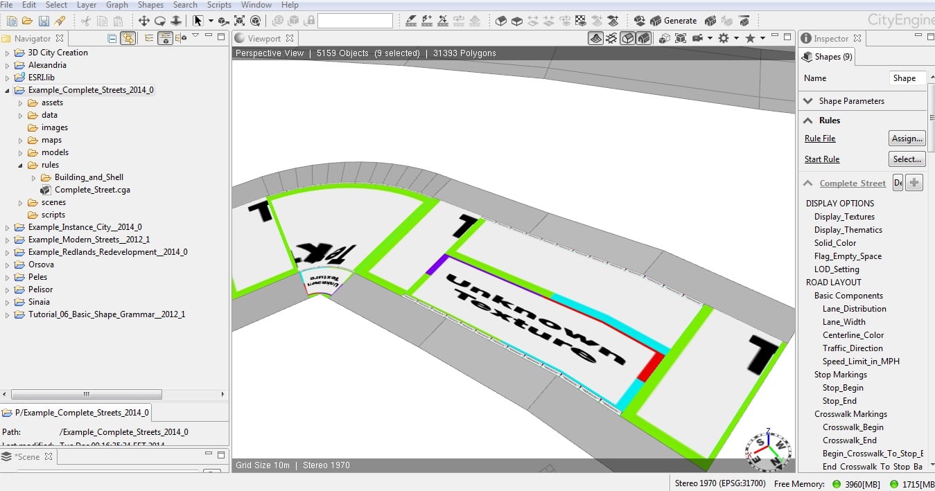

Hello,
I have downloaded the Complete_Streets_2014 Rule from resources and tried to test it but it seems that I have some problems because I imported the file which contains all the data from the .zip Complete_Streets in the Navigator but when I apply the rule the result is Unknown Texture. Also, the obj files appears as cubes. I don`t know why the path is unknown because all I did was to import the folder in the Navigator.
I did this workflow with others resources before, like Redlands Redevelopment or Modern Streets but it worked..
Thank you,
