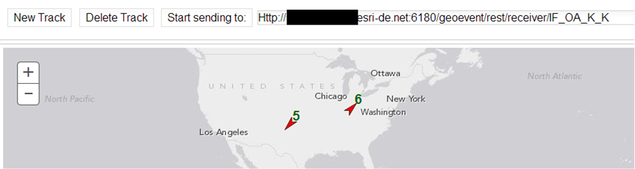

In our test scenario we have a simple GeoEvent Service that receives JSON on a REST endpoint. The output JSON will be provided via WebSocket.
To simulate the tracks that will be send to the REST endpoint we used a small JavaScript Tool that is attached.

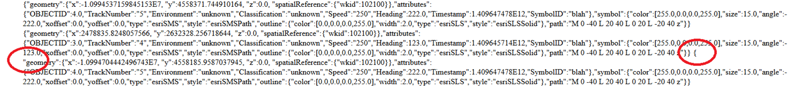

In general the data that is received via WebSocket contains valid JSON objects, but when sending more than one track to the REST endpoint, we very often receive invalid JSON objects within the data objects of the WebSocket message.
Following is unexpected in the data string of the message:
- data contains a complete JSON Track followed by one more curly bracket ‘{‘
- the starting curly bracket ‘{‘ of the JSON Track is missing
- data contains two complete JSON Tracks without any separator or squared brackets to define it as list {“geometry”: …. , “TrackID”: 1}{“geometry”: …. , “TrackID”: 2}
It’s possible to see the problem when connection the WebSocket endpoint with the integrated website:
