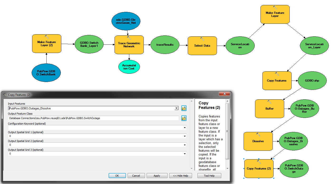

I'm using model builder because tracing a geometric network on python is a pain. In my last Tool (Copy Features) the original model copies the Input data to SDE. However when used in a Geoprocessing Service it processes the Copy into the Scratch.gdb.
How do I get it to Copy Features to SDE like the original model?

Here is a snapshot of the model, with the last tool (Copy Features (2)) open.
