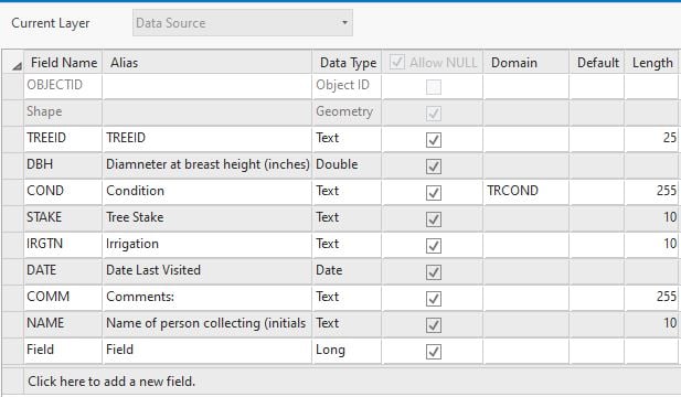

Feature layer "Trees"
Added the assiciated fields to the feature layer,

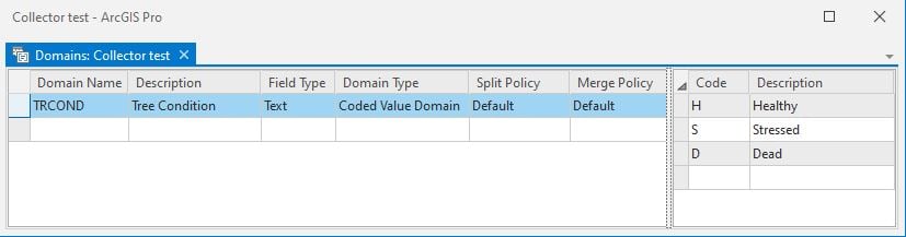

Created a domain and added the data to be collected, and then updated the field to include the domain.

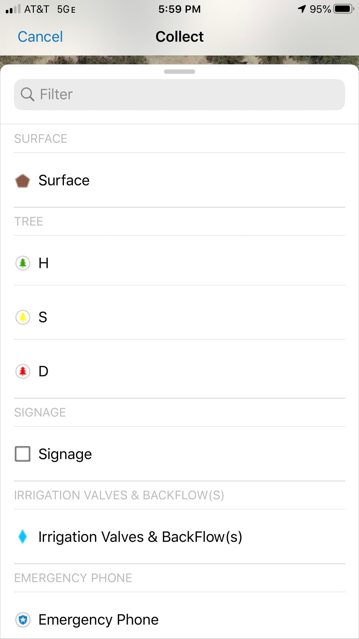

When opened in Collector, I selected a tree that I wanted to collect data on, and I'm only seeing the domain code instead of the decription.
Is there a way to list the description in the list instead of the code.
