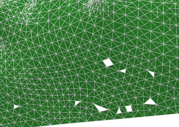

I have a strange problem, i create 3D Polygons with Arcpy from a ASCII Textfile with Nodes, Edges and Triangles.
Almost all triangles are created, 14 of 3644 Polygons are Empty. Lenght and Area are empty.
I use ArcGIS Pro 1.4.
One of this empty Polygons have this Coordinates: Point 1, Point 2, Point 3:
2574321,097 5696097,9 36,214 0
2574320,486 5696097,543 35,246 0
2574320,2 5696097,375 36,763 0
I know the coordinates are close together, but there are different. If I use the Method length3D
he's also 0.
Thank You for helping. Sorry for my bad English.
