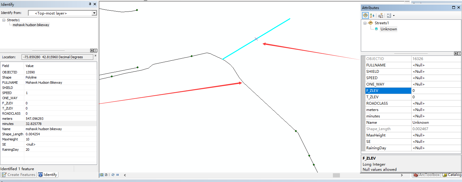

1. Got a street with several vertex:
2. Create a new street from one of the vertex (Snapping had turned on):
3. Give the new street proper F and T_ZLEV value (both are 0), which are the same as the existing one:
4. ND connectivity property set to "Any Vertex":

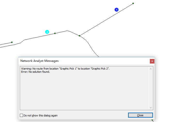

5. Build and run a Route:
The Network Identify Tool also shows that this newly created street do not have adjacent edges.
