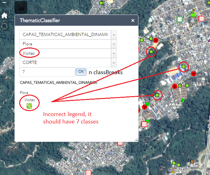

This is the problem:
I'm developing a widget that allows classify the visualization of thematic layers depending of selected field.
So, when I apply the render the first time, the legend works fine. Now, if I change de layer, it applies the render but legend take the default value, not the current value. This happens sometimes but not always, I don't understand what is hapenning.
This is my code when I create the Legend:
createLegend: function () {
htmlF = "<div id='legendDiv' ></div>";
var node = domConstruct.toDom(htmlF);
domConstruct.place(node, 'legendField');
this.legend = new Legend({
map: this.map,
layerInfos: [{
hideLayers: this.parameters.idHideLayers,
layer: this.parameters.layer,
title: this.parameters.layer.title
}, 'legendDiv');
this.legend.startup();
this.legend.refresh();
The Legend also takes an array of sublayer Ids that will be hide.
