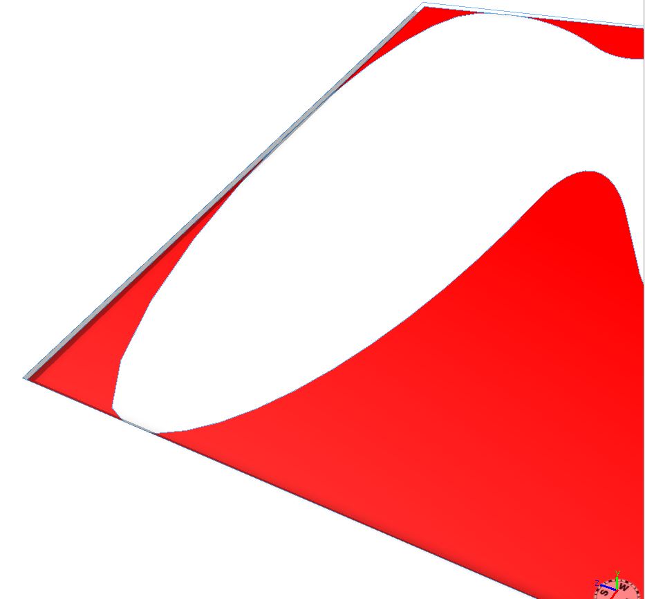

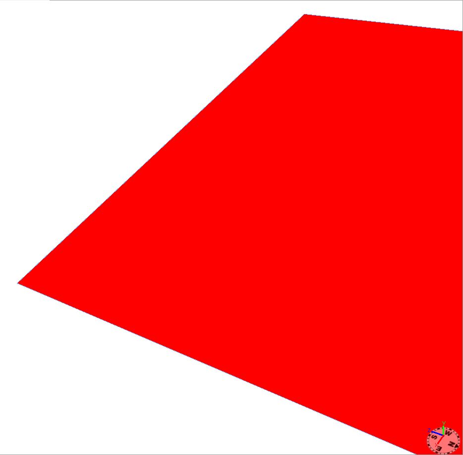

I have a problem, I want to insert an obj file into my CE scene, I have created an Oshape but when I use the import function, it inserts the object into the area, but it has been moved a bit, the obj file is just a flat surface created in rhino with lower left corner in (0,0).
as you can see there is a small cap between the white area and the read along the straight edge. Here is the code
