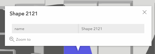

I am trying to export object attributes along with models in a scene package layer. After using the following rules (here, attributes are simplified), I am still receiving a 'name' attribute associated with shape number (see attached snip) when the models are ingested and interacted with in a web scene (uploaded manually to our Portal for ArcGIS). Any recommendations on how to get these attributes to export properly in the scene layer package? I am using CityEngine Basic 2017.
Thanks in advance!
