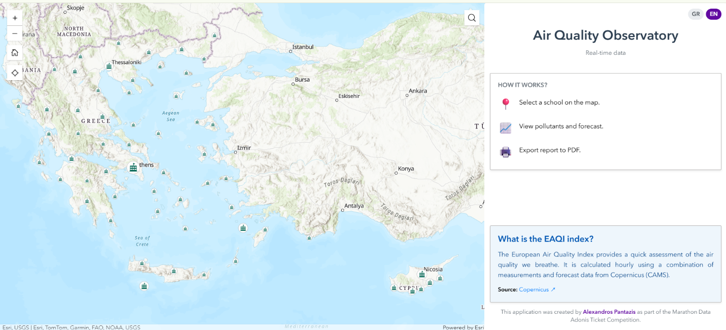

Figure 1. The Schools Air Quality Observatory welcome screen.

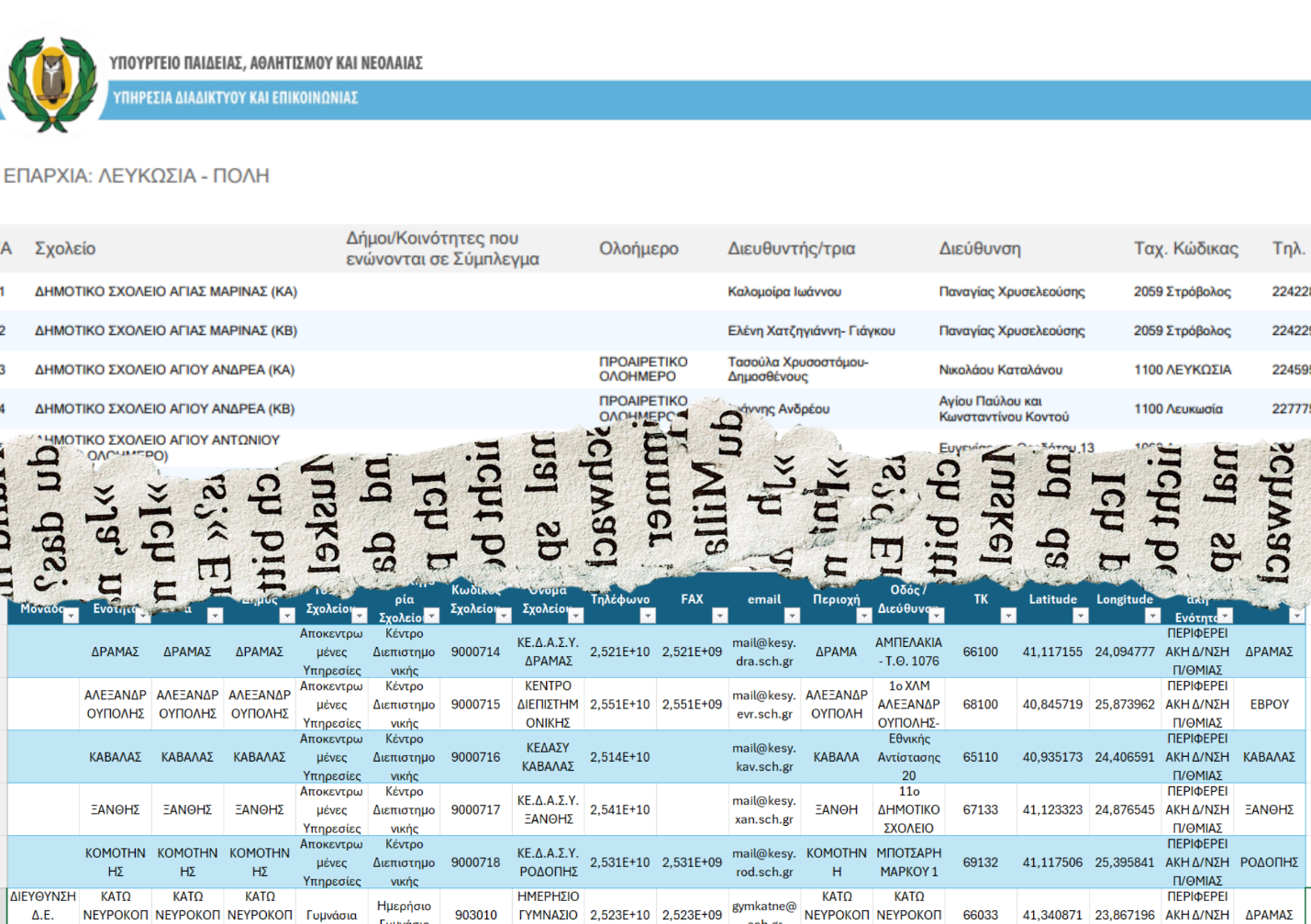

Before any air-quality work, I needed the location for every school in Greece and Cyprus. That turned out to be the hardest part of the whole project, and the two countries could not have been more different.
My initial idea was to search for data via OpenStreetMap, but in our case study countries the school data are not updated, so they are not reliable. I turned instead to the Ministry of Education of each country.
Greece was kind to me. I found the schools in a CSV table that already carried coordinates, along with names and administrative level. The integration into ArcGIS was simple. I used the XY Table To Point tool and had all the Greek schools in my project.
Cyprus was the opposite. The only list I could find arrived as a PDF, with school names and street addresses but no coordinates at all. To turn those addresses into points, I used geocoding. I extracted the addresses from the document, then ran them through ArcGIS geocoding. It still needed manual checking, because an address-only list always produces a handful of points that land on the wrong street, but in the end Cyprus joined Greece on the same map.
If there is one thing I underestimated, it is this part. Building the live air-quality features on top was satisfying and fast. Obtaining trustworthy locations for two countries, from two completely different source formats, is where the real hours went.
Figure 2. Two countries, two problems. Greece arrived with coordinates, Cyprus only with addresses.

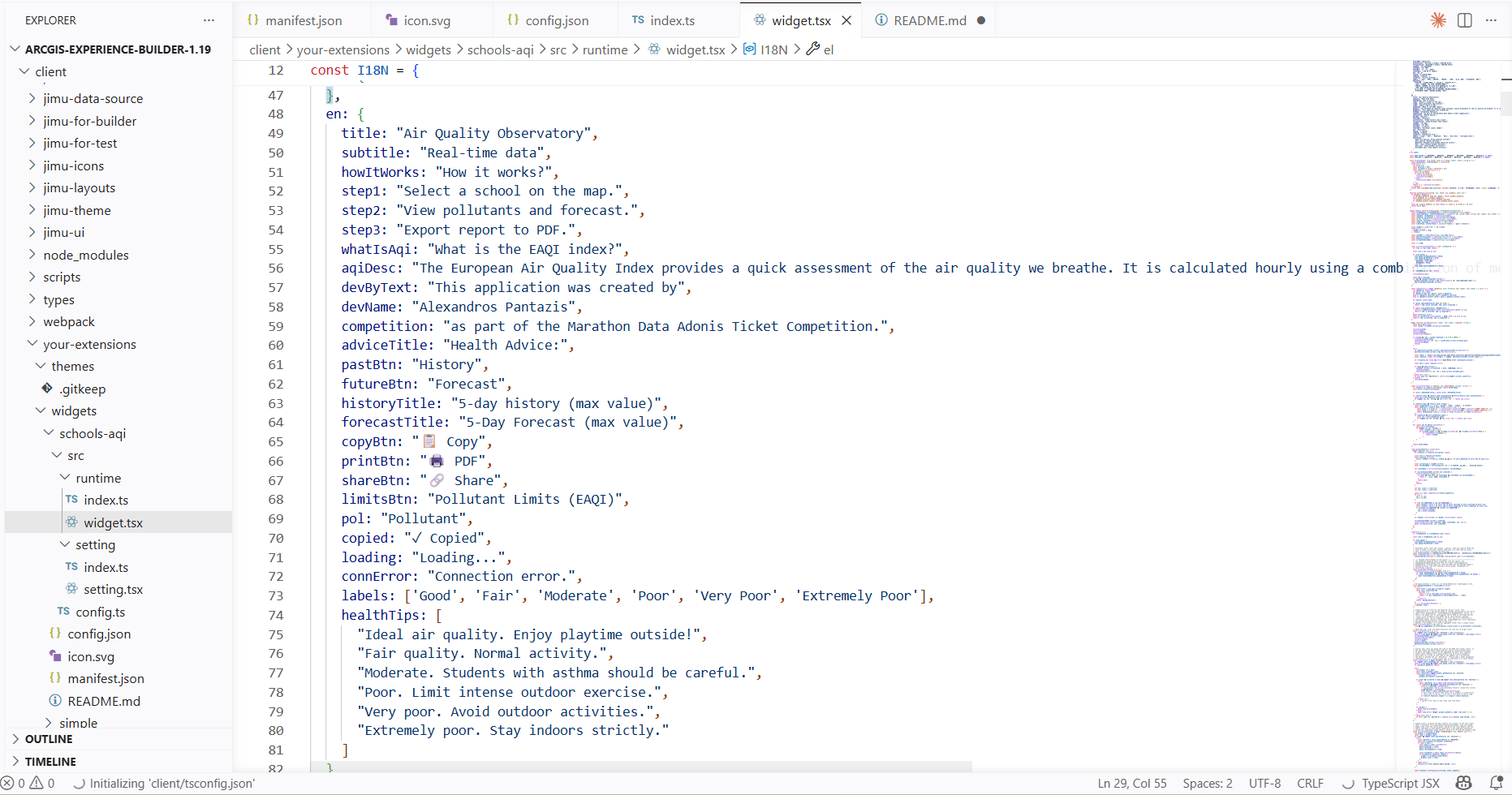

Figure 3. Experience Builder Developer Edition running locally, with the custom widget written in React and TypeScript in VS Code.

Writing your own widget means you own every rough edge. The one that cost me the most time appeared only on touch devices. On a phone, tapping a cluster of schools kept opening the map's native pop-up instead of smoothly zooming in, and that native pop-up collided with my custom panel. The app felt stuck in exactly the place it should have felt fluid.
The fix came down to three suspects, and they are worth naming, because anyone building custom map interactions in Experience Builder will meet at least one of them.
- First, the click event itself. The ordinary click event fires late enough that default behaviors can slip in ahead of you. Switching to view.on('immediate-click', ...) lets you intercept the tap the instant it lands and call stopPropagation() before the default pop-up can even start.
- Second, the cluster's own pop-up. Even with the feature layer's pop-up disabled, the clustering layer generates its own graphics for the aggregate counts, and those carry their own pop-up. You have to set popupEnabled = false in two places, on the FeatureLayer and inside the featureReduction configuration block. Miss the second one and the cluster keeps talking back.
- Third, Experience Builder's own message actions. The framework can dispatch selection messages between widgets asynchronously, and those can re-trigger a pop-up from outside your JavaScript. That one is solved in the builder interface rather than in code, by auditing which data actions are actually wired up.
