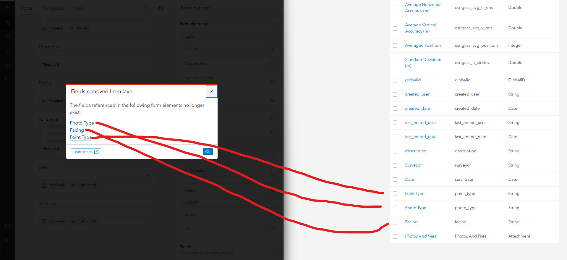

- I clicked on a different layer to change something in that form, and when I clicked back to Other Points I got an error message telling me that the three fields that I had added directly "no longer exist"
- I opened the layer details and checked the Fields list in the Data tab. The fields very much still exist.
I tried refreshing the page several times. Sometimes it remembers the fields do exist and I'm able to make one change to the form. Sometimes it does not remember they exist.
When I go to add a point in the map in the Field Maps app while the Field Maps Designer has forgotten these fields, the Other Points layer says "The form contains unsupported data". If the Field Maps Designer remembers these fields, the layer works just fine in the app.
