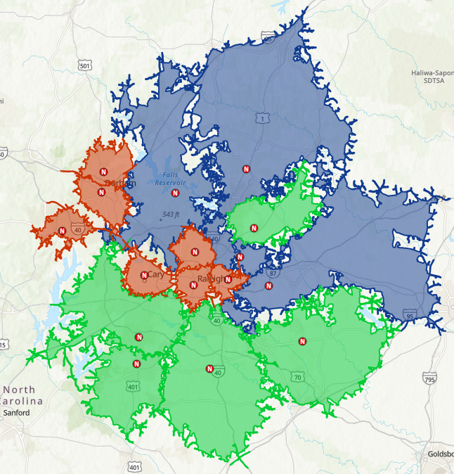

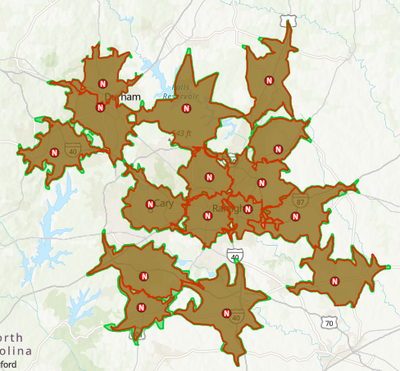

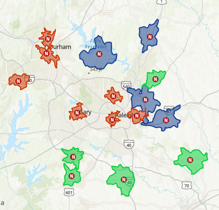

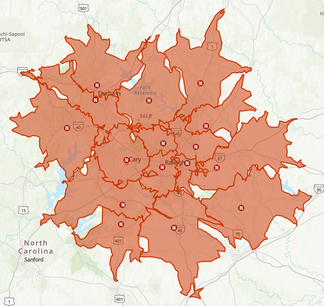

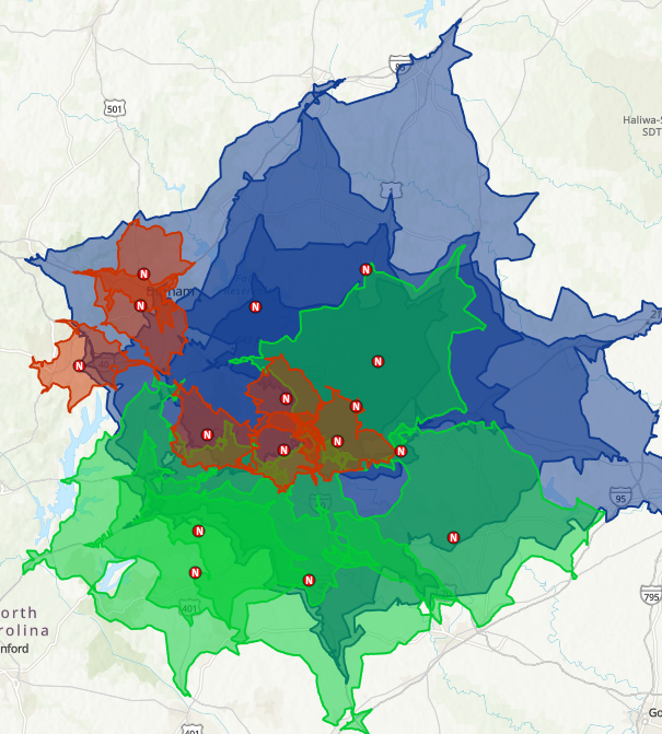

When I'm using this tool with to generate drivetimes with an expression input method, remove overlap on, generalized polygon detail, I'm getting significantly 'off' polygons in the output. But when I switch to standard polygon detail the tool outputs an accurate output that I would expect. Wondering if anyone else has ran into this or maybe it's a bug? I've tried on multiple datasets, various tool configurations, I think I narrowed it down to whether generalized has multiple values in the input or not.
Generalized DTs Single Value
General DTs Multiple Values
General DTs Expression
Standard DTs Expression
Generalized No Remove Overlap Expression
