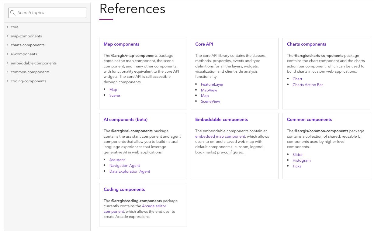

Let’s do some SDK focused updates now. References now contains 50% more components (based on number of sections)! You read that right. We added ai-components and common-components at this release, and you can now find them in our References page.
But that’s not all. If you expand the map-components section, you’ll see that we updated the documentation to make the information clearer and more logical. All components now use a lowercase kebab-style naming convention, and some types have been moved into sections directly below their component. This is part of our progress to transition from widgets to web components (all widgets are now deprecated as of version 5.0).

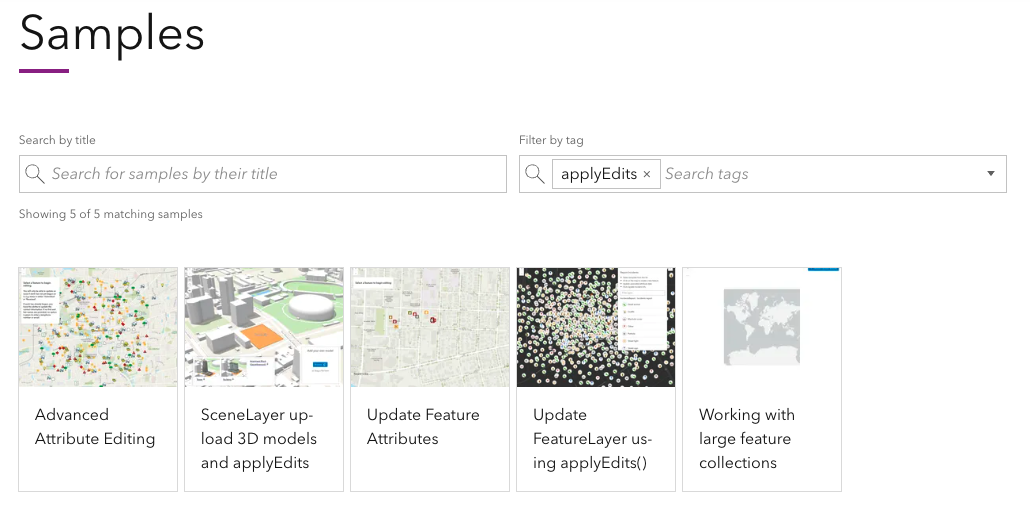

I know it’s a lot already, but let’s do one more SDK update, and then we’ll look at some API features. The Sample Code page was enhanced with a much more robust search experience. You can now search by title and/or tag, and it is so fast and nice.
Here’s an example of searching for a sample that does some editing, but it doesn’t matter if it’s using a method or a component to do the work, so I filter by the “applyEdits” tag (instead of “Editor” by title):

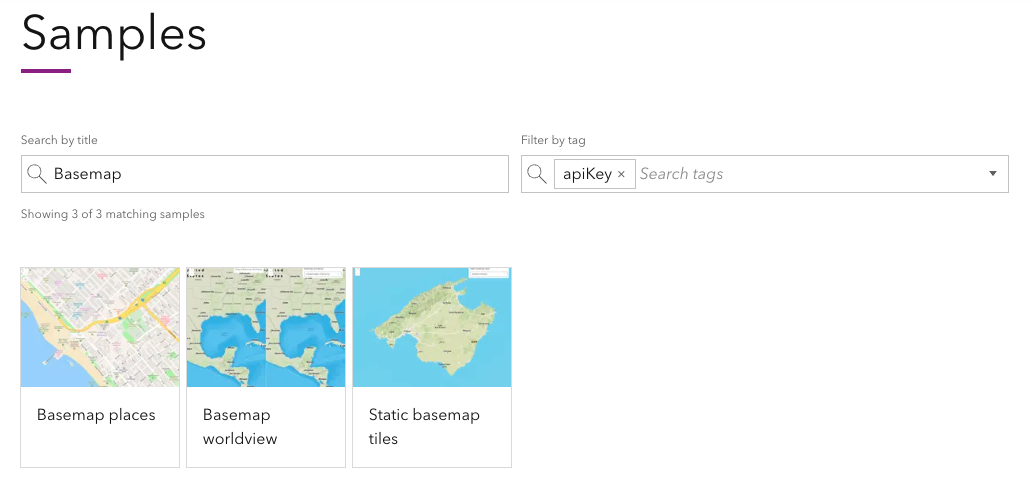

Or, I could search for samples that have “Basemap” in their title, because I remember there was a neat sample I had seen with “Basemap” in the title. And I also need that example to use API keys. Now, I can search for both at the same time:

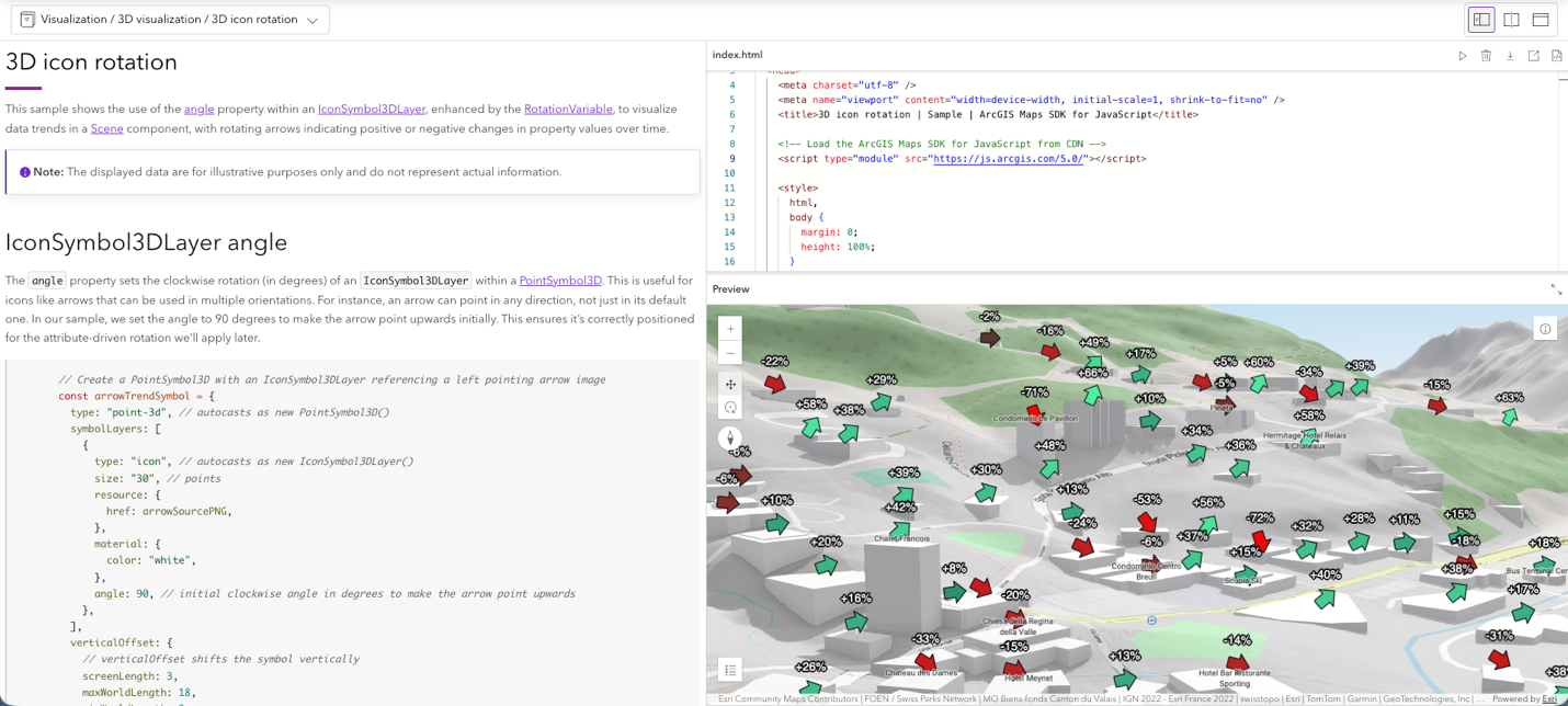

Want to see something even cooler? Open a sample, and then look at the wonderful new UI. On one page you have the description, the code, and the app, with a couple delightful rows of buttons (in the top-right) to help you toggle on/off parts of the page, or to modify the app’s state.
