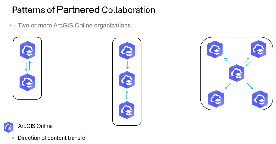

Partnered collaborations only involve ArcGIS Online organizations – here are a few patterns of use.
An example for how to use partnered collaborations would be sharing asset data through your utility’s ArcGIS Online with the local fire department’s ArcGIS Online during an ongoing wildfire.

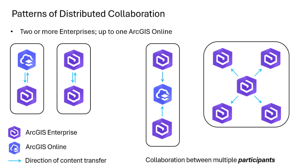

On the other hand, distributed collaborations are collaborations that involve an Enterprise organization. This can mean multiple Enterprise organizations, or one Enterprise and one ArcGIS Online. Below are a few potential patterns of use – the diagram on the far right could represent your utility’s Enterprise organization sharing asset location information with other Enterprise organizations (like the local police department, fire department, city government, etc.)
Distributed collaborations are commonly used among natural gas utilities to share information between their Enterprise and their ArcGIS Online, as in the diagram on the far left. This could look like anything from resilience monitoring to having a continuous stream of audits from your ArcGIS Online into your Enterprise.

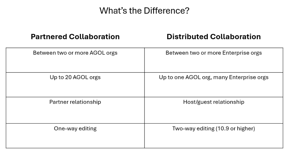

See the chart below for a summary of the differences between partnered and distributed collaborations.
The chart above mentions two-way editing – two-way editing is a way to share data between two organizations, have the ability to edit data belonging to another organization within that collaboration, and then share those changes between the organizations. Two-way editing is only available in distributed collaboration, as the chart above mentions. As a natural gas utility, two-way editing could be used in a collaboration with the contracting organization in which corrections could be made to submitted inspections. Just as a reminder, two-way editing is optional and permissions can be managed as needed.
