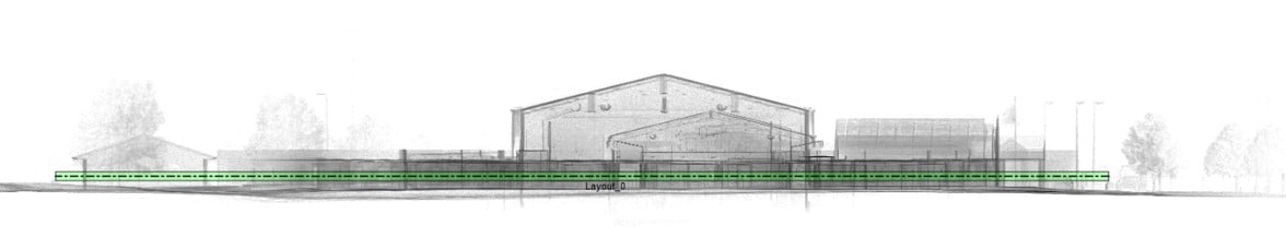

The point cloud data is further processed and segmented to extract floor plan information into vector GIS features.
Point Cloud Slicing
