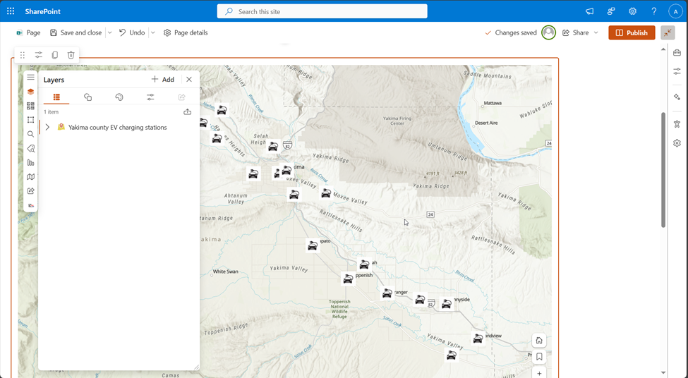

Step 1 - While the SharePoint page is in Edit mode, add the ArcGIS web part. Sign in to your ArcGIS organization.
Step 2 - Add the ArcGIS feature layer to the map.

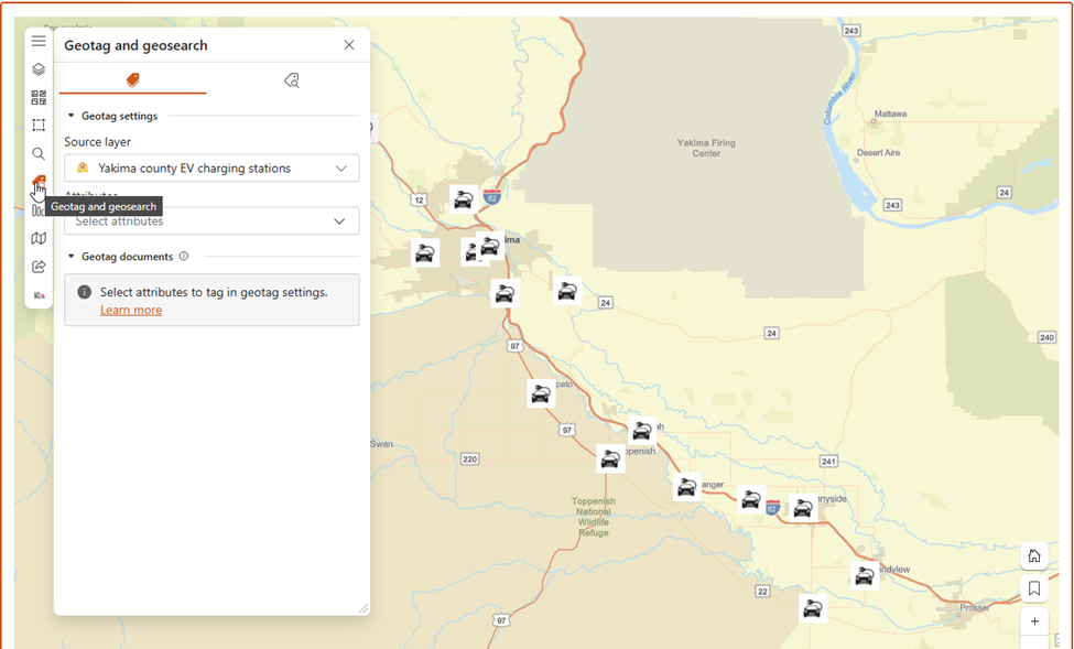

Step 3 – Open the Geotag and geosearch tool
Step 4 – In the Source layer drop down, select the layer for geotagging

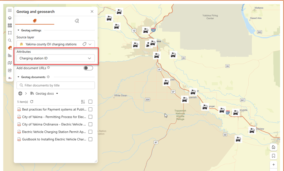

Step 5 – Configure an Attribute for geotagging

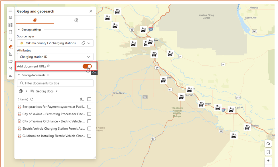

Step 6 – Turn on the Add document URLs toggle button

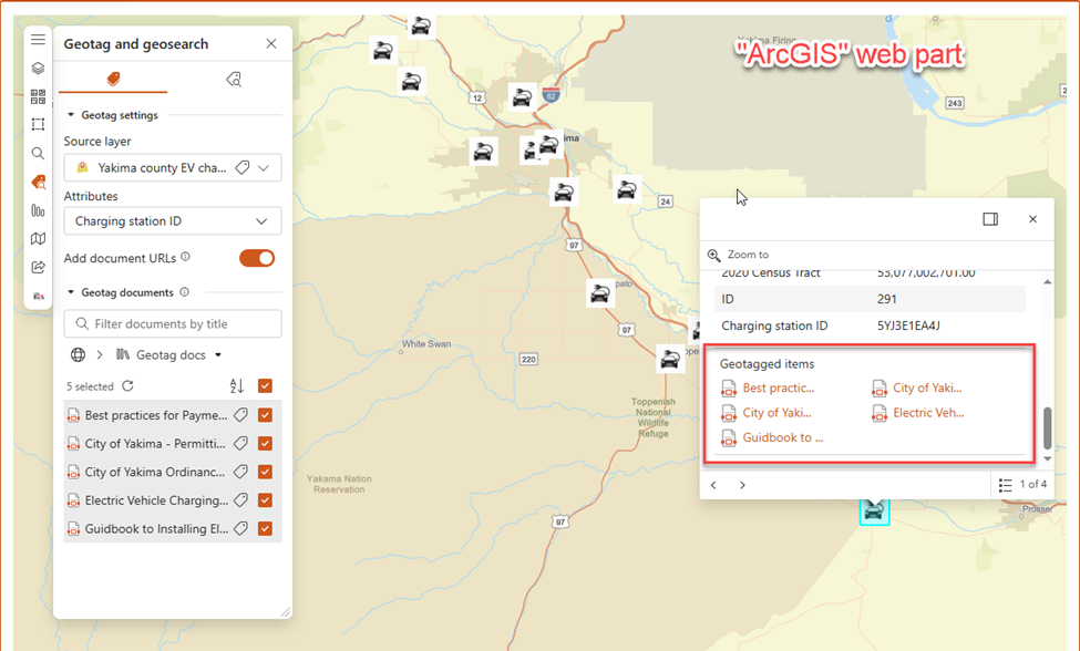

Step 7 – Select the document library which contains the documents to geotag. Next, select the documents and tag the documents to the required features by dragging and dropping the documents directly on the feature(s). Once the tagging is successful, you will see a toast message in the top right corner of the map

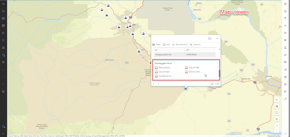

You can now view the document links in the feature pop-ups either in the ArcGIS web part or in the Map Viewer popup.
Note: Once the owner of the feature layer has turned on the Add document URLs toggle button in the SharePoint page “Edit” mode, geotagging can be performed both in Edit mode and Run mode. To turn on/off the Add document URLs toggle button, the SharePoint page has to be in Edit mode.

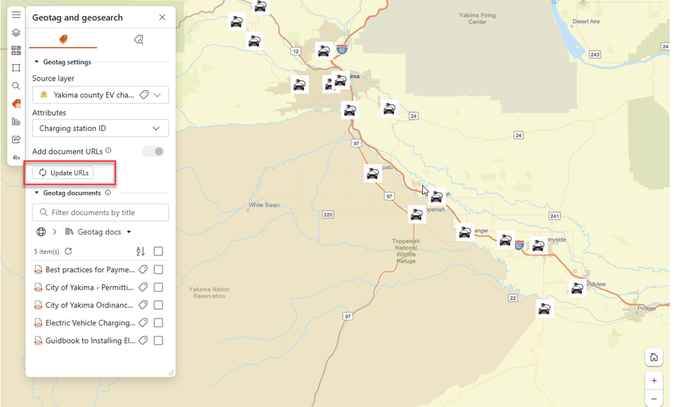

Update URLs: Once the documents are geotagged using this new feature, at some point in the future when documents are deleted from SharePoint, the document URLs on the ArcGIS platform will no longer be “in sync” with the geotagged documents on the SharePoint platform. To address this situation, you can use the Update URLs button to remove the links associated with the deleted documents from the ArcGIS platform
