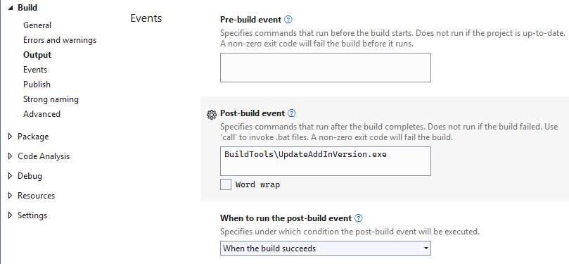

Step 5: Create a “Post-Build event” in your AddIn or Configuration project to run this tool to edit the version attribute in your add-in’s config.daml. Follow these steps to create the post build event:
- Right click the Add-in or Configuration project in the Solution Explorer and select Properties in the context menu.
- Expand the Build folder and select Events.
- In the “Post-Build event” text box, invoke the UpdateAddInVersion.exe from its folder (step 4). In the screenshot below, “BuildTools\UpdateAddInVersion.exe” has been added to the Post-build event text box.
- Visual Studio will now run this tool during the build. The version attribute in the config.daml will be incremented by the UpdateAddInVersion.exe.
On a successful build, the post build call will auto-increment the last element of the version attribute in the config.daml: so version=”1.0” becomes version=”1.1” and version=”1.0.0” becomes version=”1.0.1”. It will update the last element of the version, no matter how many elements the version has.
