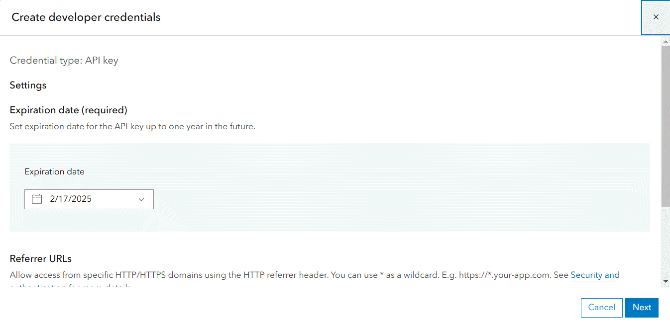

- The "Create developer credentials" pop-up window will appear. In this window set the expiration date and optionally the referrer URLs, then click the “next” button.

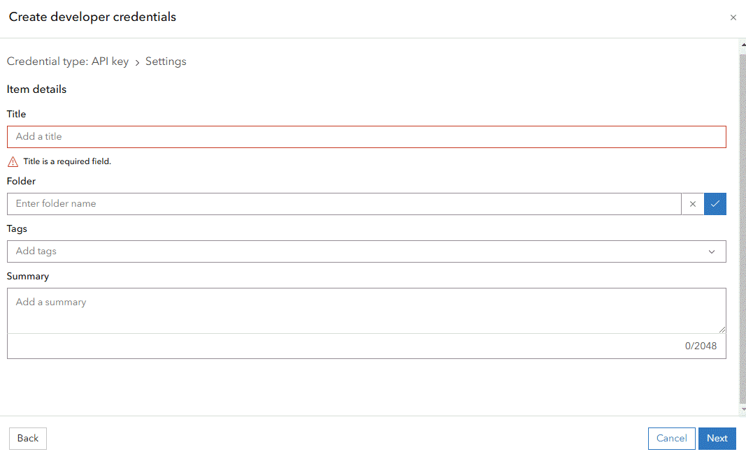

- Give the API key a unique title (e.g., based on the user or group that will be assigned the API key) and optionally fill out the other settings, then click the “next” button.

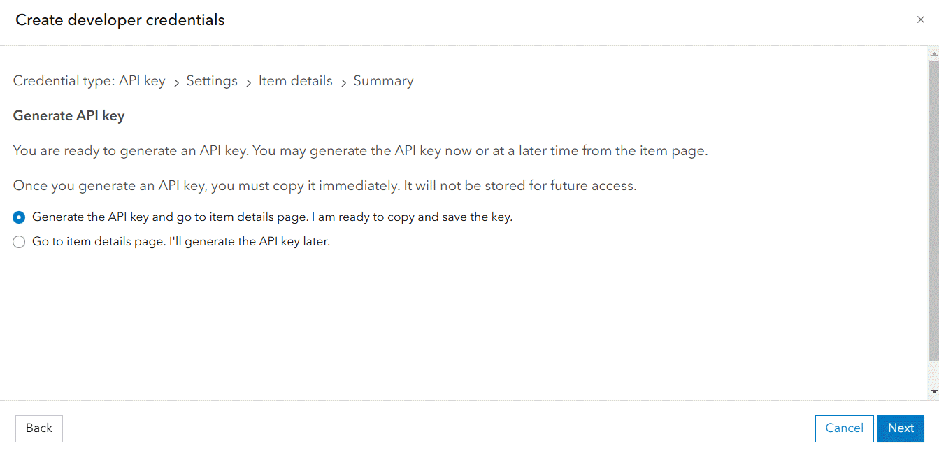

- An option will be provided to generate the API key now or later. Select an option and click the "next" button.

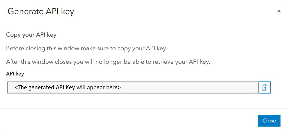

Note: Once the API key is generated, it must be copied immediately to a secure location, given that it is not stored for future access. Following the API key security best practices will help keep the API key secure.
- If the option to generate the API key “now” was selected, the API key will appear in a new pop-up window. This API key is used to authorize GeoAnalytics Engine. As noted in step 5 above, following the security best practices will help keep the API key secure.

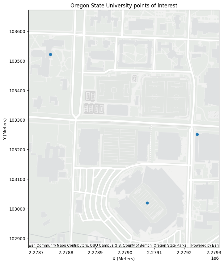

# Plot the DataFrame (Note: `%matplotlib inline` might be needed to make the plot appear)
df_plot = df.st.plot(basemap="light", xmargin=0.15, ymargin=0.3, figsize=(10,10));
df_plot.set_title("Oregon State University points of interest")
df_plot.set_xlabel("X (Meters)")
df_plot.set_ylabel("Y (Meters)");root
|-- id: long (nullable = true)
|-- point: point (nullable = true)
|id |point |
|1 |{"x":2279074.576461232,"y":103019.15556246601}|
|2 |{"x":2278748.209109826,"y":103521.65548041835}|
|3 |{"x":2279243.741068326,"y":103250.88697086088}|
