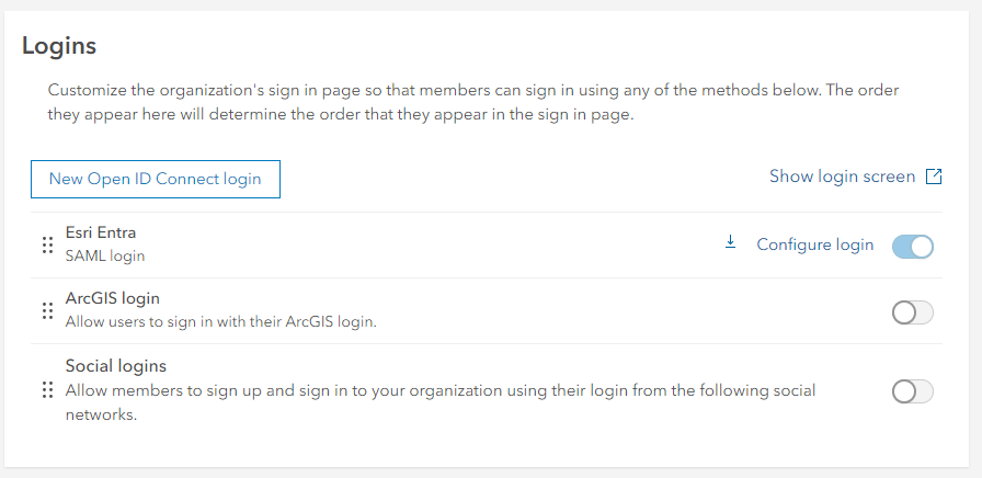

In ArcGIS Online, you have the ability to configure the login page for your users.
We recommend only enabling the SAML login as shown here:
With this setting enabled, users can go to your ArcGIS Online URL (https://baldwinuniversity.maps.arcgis.com) and it will automatically attempt to sign them in via your universities SAML credentials. They won’t need to enter a URL or get confused by a ‘named user’ sign-in box.

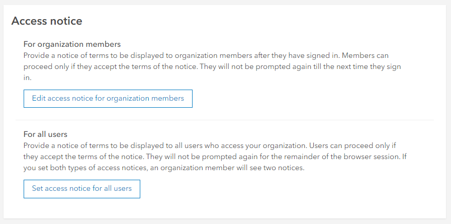

Lastly – you can also set an ‘access notice’ that will be presented to users when they log into ArcGIS Online or ArcGIS Pro (example included in the short GIF further down).
Here is a basic demonstration of what the experience will look like to users (as a note, I didn’t need to enter my SAML credentials because my most recent login was still cached):

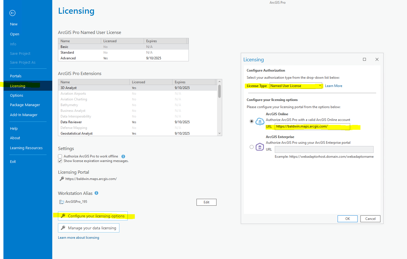

If you want to make changes via the ArcGIS Pro UI, you can navigate to Settings, and then Licensing, Configure your licensing options, change the License Type to ‘Named User License’, and then enter in the portal URL ex. ‘https://baldwinuniversity.maps.arcgis.com/’

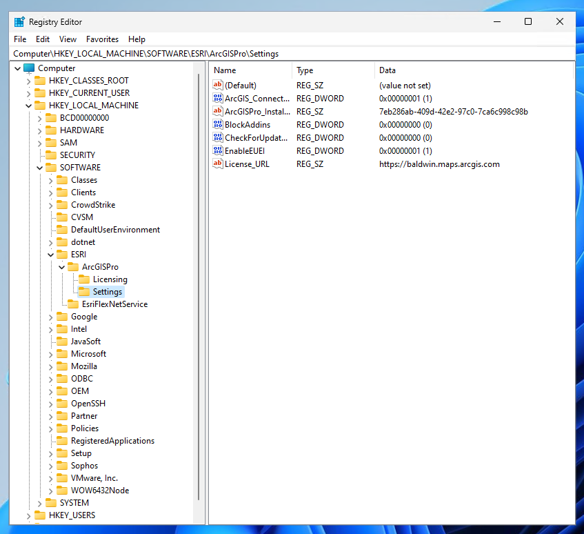

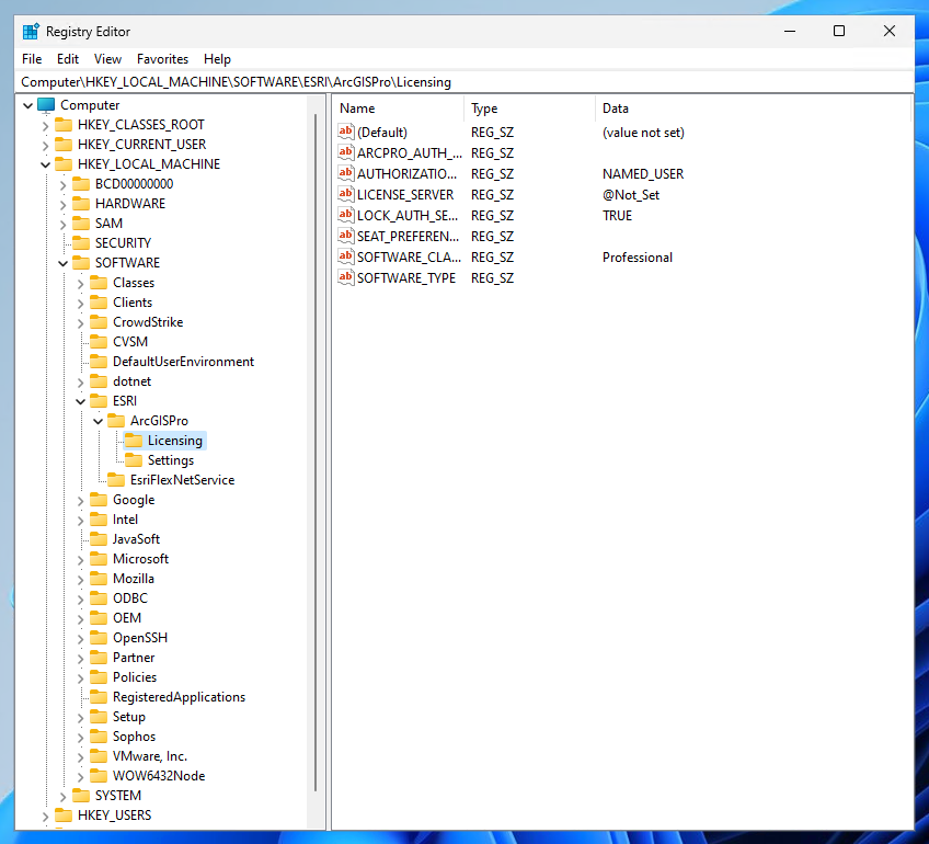

LOCAL_MACHINE updates

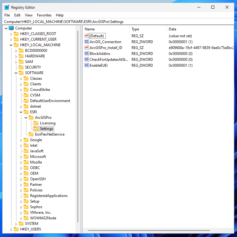

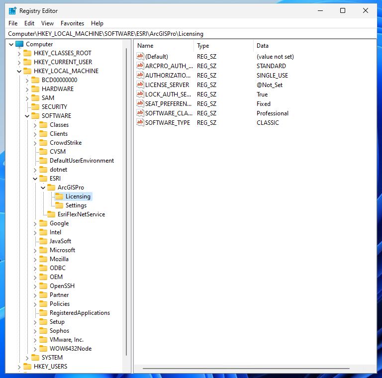

In the Windows Registry Editor, under HKEY_LOCAL_MACHINE, Software, Esri, ArcGIS Pro, you should find 2 keys (Licensing and Settings) that look similar to the ones below. These screenshots are from installation that used a single use license with the silent install.
Under Licensing, the following changes need to be made:
- AUTHORIZATION_TYPE from SINGLE_USE to NAMED_USER
- SEAT_PREFERENCE - deleted value (Fixed)
- SOFTWARE_TYPE - deleted value (CLASSIC)
Under Settings, the following changes need to be made:
After you make the changes, it should look like the following screenshots:

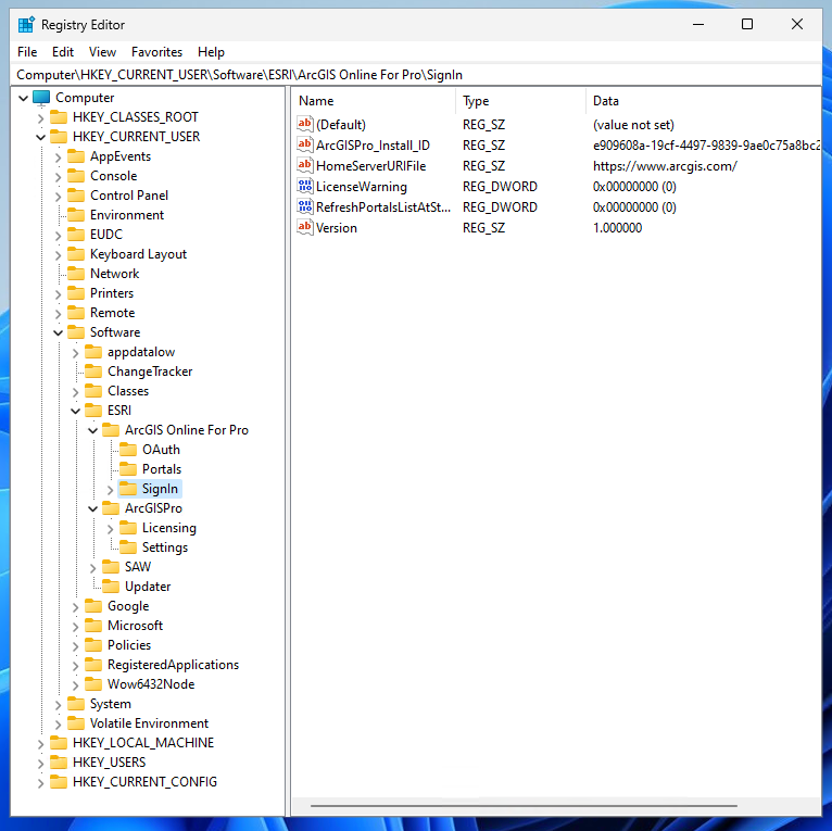

USERS updates
So – you have now created the settings for any ‘new’ user that logs onto the machine via the LOCAL_MACHINE registry settings, but we also need to update the settings for any existing user profiles, or delete existing keys.
For all existing user profiles, you can either delete the following keys (the entire 'folder' listed in bold):
- HKEY/Software/Esri/ArcGIS Online for Pro
- HKEY/Software/Esri/ArcGISPro
Or, you can update values in those keys.

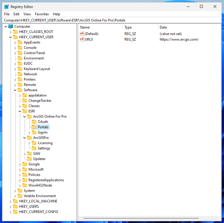

Manual Process To Update USERS
The following description explains how one could do this manually, but this process would need to be scripted in order to update the large number of user profiles on each machine.

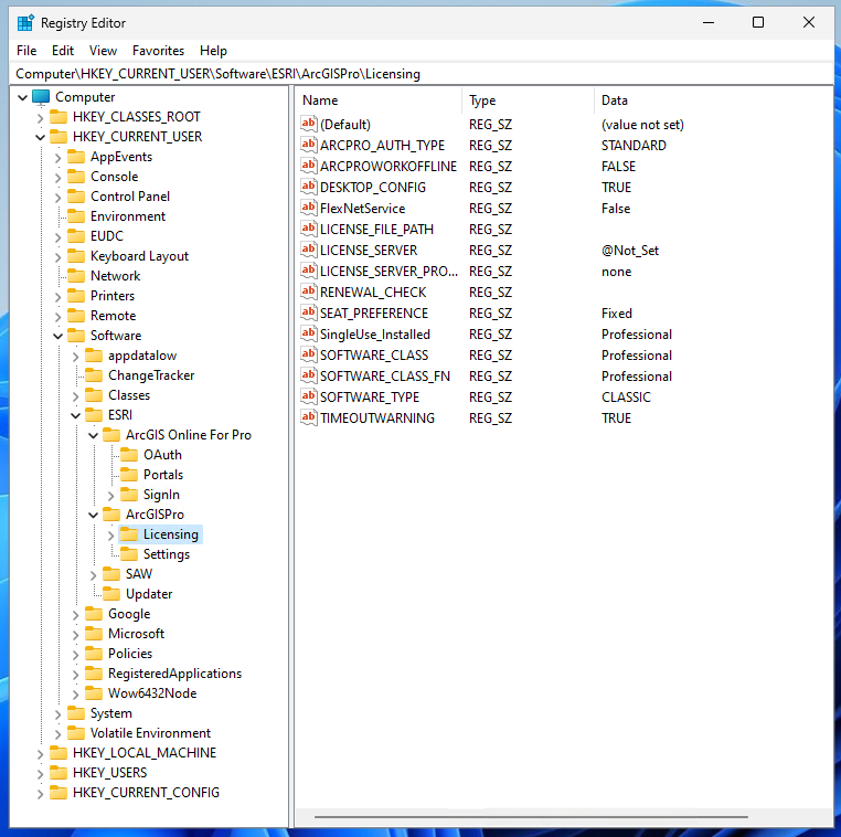

The following screenshots show the CURRENT_USER keys for ‘Portals’, ‘SignIn’, and ‘Licensing’ after the user opened ArcGIS Pro in a single-use license deployment.
Under Portals, the following changes need to be made:
Under SignIn, the following changes need to be made:
- Update ‘SOFTWARE_TYPE’ to ArcGIS Pro
