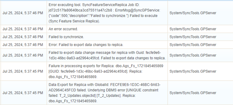

After upgrading to 11.3 we're getting failed sync's and consistent error logs in server manager.
Field-collected edits are successfully synced to the SDE geodatabase, but the users are unable to sync in the download direction (from SDE geodatabase to Field maps device). A lot of edits/manipulation is done when the upload sync happens via attribute rules, and the field staff are UNABLE to then sync these edits to their devices, causing field-chaos.
