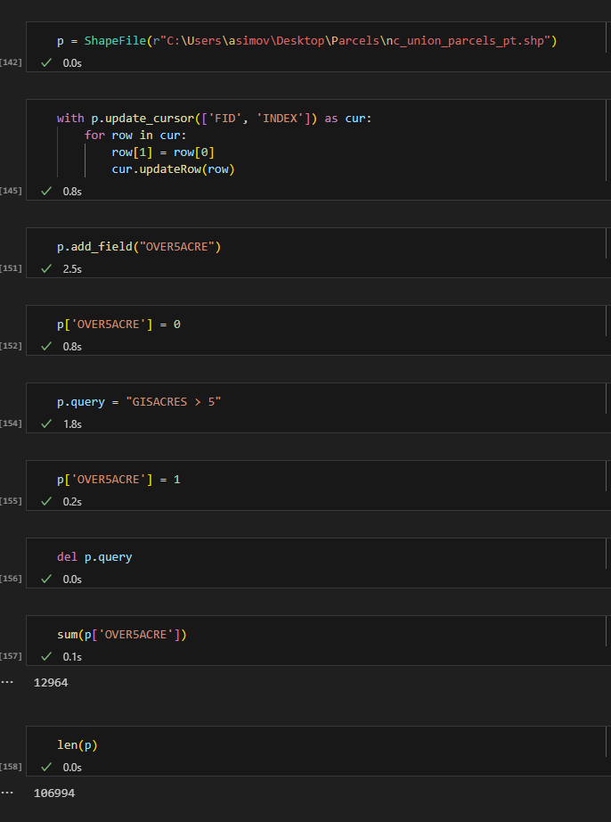

I've been working on a module that wraps common arcpy operations with Arcpy objects and makes interacting with them more "Pythonic". Basically meaning I wrote a bunch of 'dunder' methods and error handling that allows you to initialize an object with a path to a Shapefile or FeatureClass and then get a bunch of best practice interactions with that data without having to use boilerplate:
In this example:
- Initialization with datapath
- Built in update cursor used to set one field equal to another
- Field added to flag records as "Over 5 Acres"
- The "OVER5ACRE" field is defaulted to 0
- A Query is applied to the object
- All visible records (queried above) have their "GIS5ACRE" field set to 1 (True)
- Query is removed
- A list of all values for "GIS5ACRE" in the table is summed (this is equivalent to using len() when the query is active)
- The length of the unqueried data is shown to compare
This is just a simple toy example. I can write up a more detailed explanation, but for now I just wanted to test the waters on this as a concept. Having the community help with maintaining an interface like this would mean we could bake a lot of the more convoluted Arcpy methodology into simpler syntax that more regular Python devs would be familiar with.
