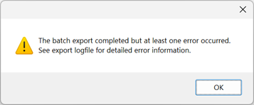

In CityEngine the type of an object attribute’s value does not have to be the same across multiple shapes, but this is a requirement for Esri’s FileGDB format. If such a type mismatch is present in your scene, the export to FileGDB will fail with the following message:
The batch export completed but at least one error occurred. See export logfile for detailed error information.
If you inspect the details of the entry in the Log (Window -> Log -> Select entry -> Context Menu -> Event Details) you can find a line similar to the one below at the top of the Exception Stack Trace:
