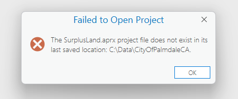

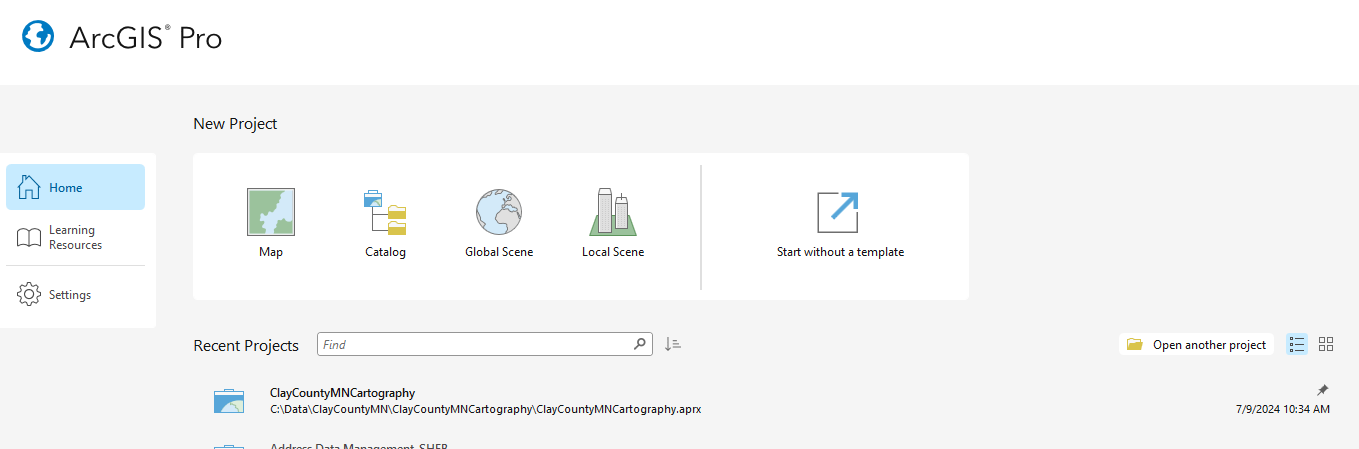

I'm also unable to open a project from under the "Recent Projects" list on the Home screen. I get the following sort of message.

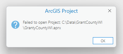

Near the Recent Projects list there's a button to "Open another project". This method gives me a similar error

The soundest method I have for opening an aprx is to launch a blank instance of pro from the start menu or task bar icon. Then as EzekielBaye has commented, select "Start without a template". Taking this route, for whatever reason prevents the frozen ribbon and missing quick access buttons issue. From here I can open an existing project with the Open Project menu (folder icon button on quick access) -or- by clicking Project tab on the ribbon > Open > choose a project
