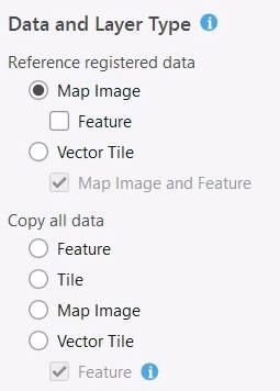

In ArcGIS Pro, when you choose to share a layer to your ArcGIS Enterprise portal, you are presented with several options:
What happens when you choose each option? To answer that question, it is a good idea to understand the difference between data, layers, and services:

Reference registered data
When sharing, the first choice you need to make is how the service should access the data. One option is to use a data store that you manage and give the service permission to access that data store. The most common reason to do this is because you want the service to use the authoritative data in your enterprise geodatabase. There are two sharing options in ArcGIS Pro that reference registered data.
Map Image

Copy all data
If you do not reference registered data, you must choose to copy the data into a location managed by ArcGIS. Some use cases require ArcGIS-managed data. In some cases, it can also be more convenient to release the responsibility of data management. When you copy all data, is important to note that if you delete the layer, the copy of the data is also deleted.
There are four sharing options that copy all data. Some of these options also create a Service Definition item in your portal content that can be safely deleted.
