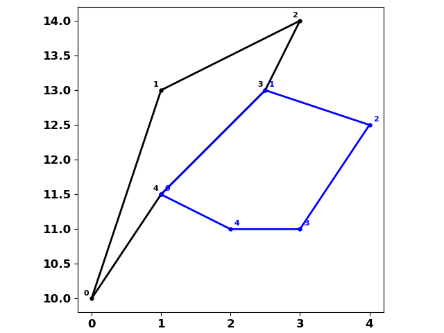

# -- Two polygons
a
array([[ 0.00, 10.00],
[ 1.00, 13.00],
[ 3.00, 14.00],
[ 2.50, 13.00],
[ 1.00, 11.50],
[ 0.00, 10.00]])
b
array([[ 1.00, 11.50],
[ 2.50, 13.00],
[ 4.00, 12.50],
[ 3.00, 11.00],
[ 2.00, 11.00],
[ 1.00, 11.50]])
Which look like this.

Lets break down line 18.
a[:, None] == b # -- `a` is broadcast so that each segment can be compared to `b`
array([[[0, 0],
[0, 0],
[0, 0],
[0, 0],
[0, 0],
[0, 0]],
[[1, 0], # -- one match
[0, 1], # -- one match
[0, 0],
[0, 0],
[0, 0],
[1, 0]], # -- one match
[[0, 0],
[0, 0],
[0, 0],
[0, 0],
[0, 0]],
[[0, 0],
[1, 1], # -- both match --
[0, 0],
[0, 0],
[0, 0],
[0, 0]],
[[1, 1], # -- both match
[0, 0],
[0, 0],
[0, 0],
[0, 0],
[1, 1]], # -- both match
[[0, 0],
[0, 0],
[0, 0],
[0, 0],
[0, 0],
[0, 0]]])
# -- next ... reduce the dimensions by 1
(a[:, None] == b).all(-1)
array([[0, 0, 0, 0, 0, 0],
[0, 0, 0, 0, 0, 0],
[0, 0, 0, 0, 0, 0],
[0, 1, 0, 0, 0, 0],
[1, 0, 0, 0, 0, 1],
[0, 0, 0, 0, 0, 0]])
# -- next ... and one again. Note -1, means the last axis
(a[:, None] == b).all(-1).any(-1)
array([0, 0, 0, 1, 1, 0])
# -- finally, the comparison has been reduces from a 3 dimensional array, to 2D to 1D
# -- the result
np.sum((a[:, None] == b).all(-1).any(-1))
# two points which `a` meets `b` at points 3 and 4 (good old `nonzero`)
np.nonzero((a[:, None] == b).all(-1).any(-1))[0]
array([3, 4], dtype=int64)
# if we reverse `b` and `a`
np.nonzero((b[:, None] == a).all(-1).any(-1))[0]
array([0, 1, 5], dtype=int64) # -- 0 and 5 are the start and end point of `b`
