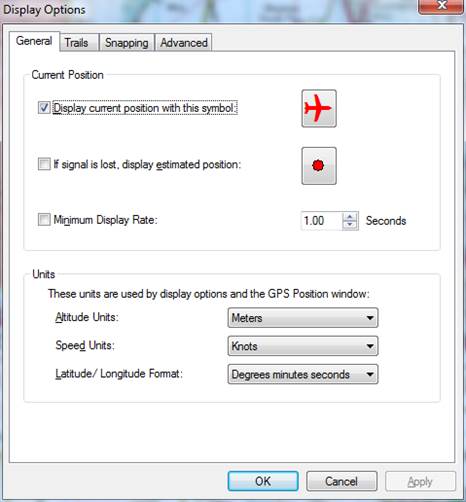

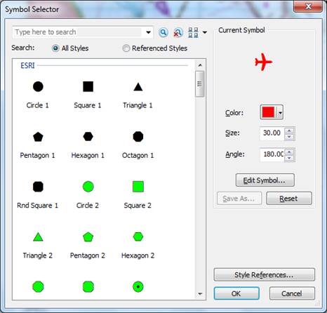

1 The symbol for the GPS location is very small and difficult to see against a busy map background. There does not appear to be an option to change the symbol size and colour.

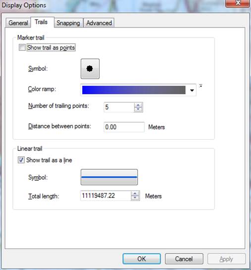

2 There are no options to create an active trail for where you have flown as you can in ArcMap.

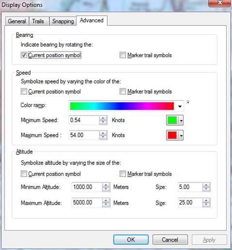

In ArcMap there were options to alter the display of live GPS data without the need to create a feature class.
Below are screen shots of the ArcMap options we would like to have access to in Pro.

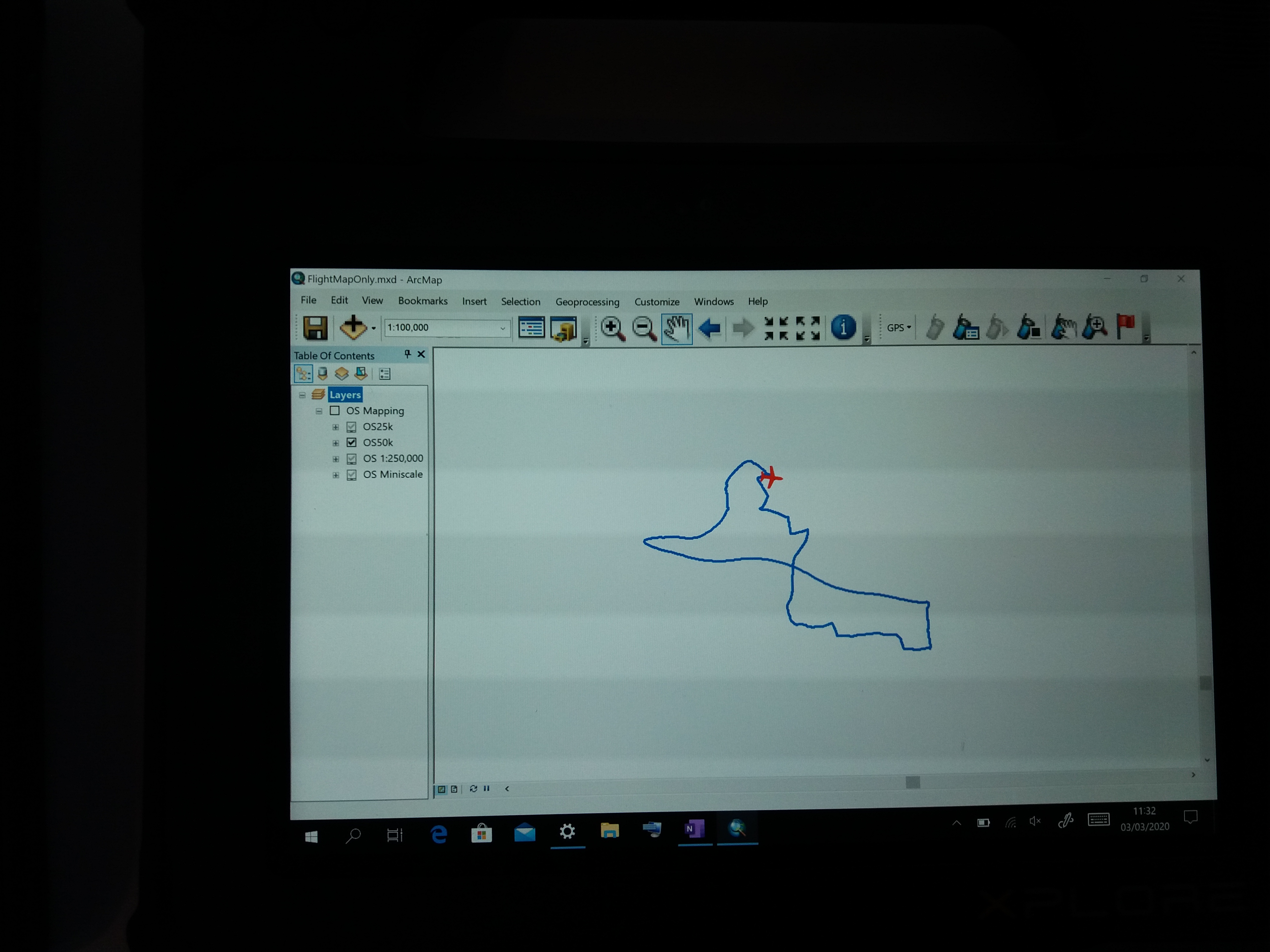

Here is a simplified example of what a flight trace looks like in ArcMap
