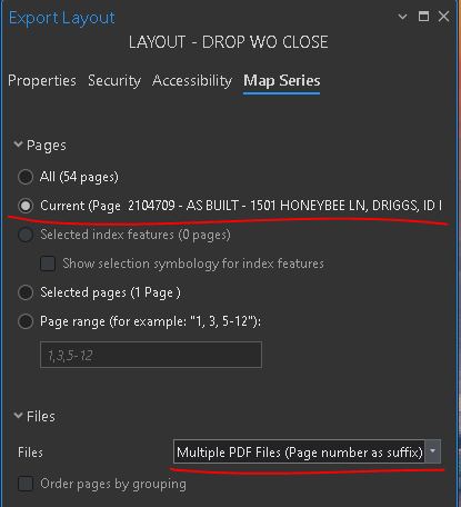

This is the field I used as page number in map series:
Map Series setting that put file name as page number:
Map Series setting when in the export layout pane:
Where and how I would tell it to export:
