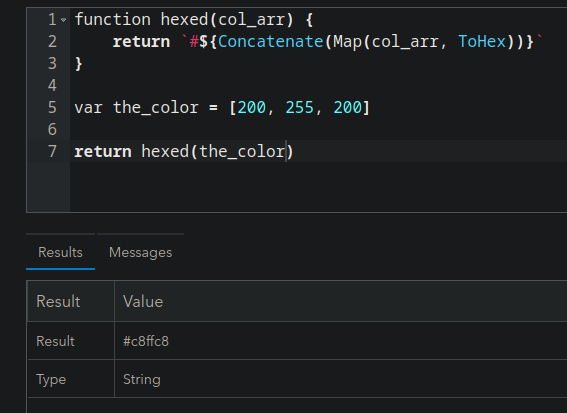

For some of the functions below, it's a lot easier to work with our red, green, and blue values as actual numbers. Or rather, as an array of numbers. But to use these in our output, we need to get them back to a string. Ironically, the example expression given for the function ToHex is exactly this. We can call that function inside of Map to apply it to each item in our array.
function hexed(col_arr) {
return `#${Concatenate(Map(col_arr, ToHex))}`

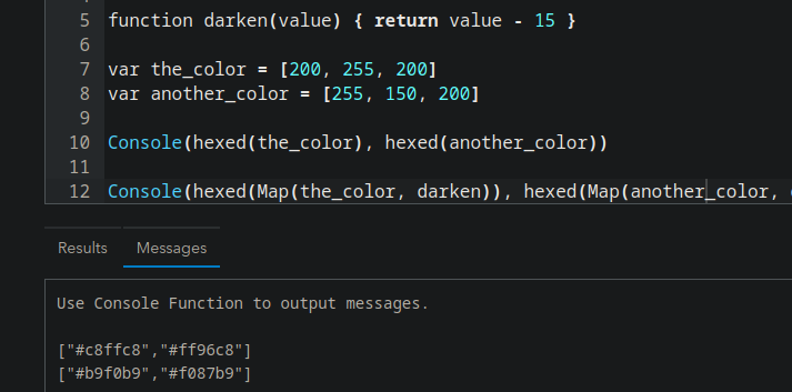

Darken and Lighten
In my daily work, I use both ArcGIS Pro and QGIS regularly. One of my favorite functions on the Q side is darken (and its counterpart lighten). The general idea: take any color, and shift its value by a specified amount. Hard (but not impossible) to do with a hex string, but an array of numbers? Easy!
Again, we can just define the function and use Map to accomplish this.
function darken(value) { return value - 15 }

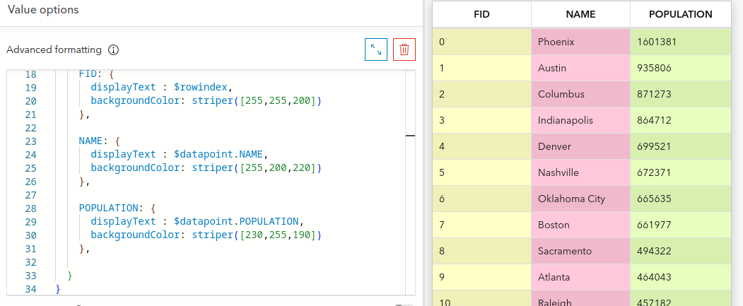

In Practice: Table Row Striping and Dynamic Background Colors
Having row striping in a table is great. But when you turn on Arcade formatting, that goes away. Yes, we have the global $rowindex, but what if individual cells have dynamic background colors? Let's say I have a cell that shows up as red, yellow, or green.
field_name: {
backgroundColor: Decode(
$datapoint['field_name'],
'High', 'red',
'Med', 'yellow',
'Low', 'green',
Implementing row striping with the rowindex global isn't hard, but it is tedious!
field_name: {
'High', Iif($rowindex % 2 == 1, 'red', 'slightly darker red'),
'Med', Iif($rowindex % 2 == 1, 'yellow', 'slightly darker yellow'),
'Low', Iif($rowindex % 2 == 1, 'green', 'slightly darker green'),
Repeat for every cell with a dynamic background color? No thanks! Let's wrap up those other functions into one:
function striper(col_arr) {
return iif(
$rowindex % 2 == 1,
hexed(col_arr),
hexed(Map(col_arr, darken))
Here it is, applying across columns with per-column colors specified. Note that I only need to define the "primary" color, and the striper function keeps the consistent 15-point shift across all of them.

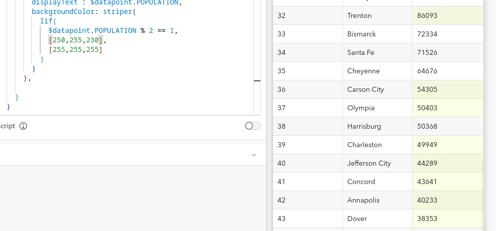

But I did mention dynamic cell colors. So let's color our population column differently whether it is even or odd.
If your colors are too divergent, it's possible that this can make your table harder to see. But the point is really that by using a function like this, you can have consistent row striping without having to worry about re-defining a lighter and darker color together. Just play around with your primary colors! Is the striping too obvious? Turn it down in the darken function, and it adjusts everywhere!

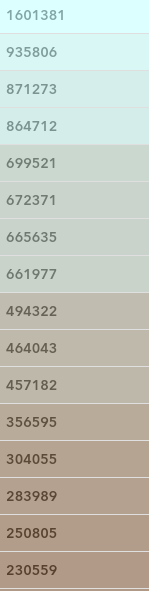

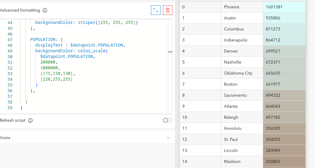

A Two-Point Color Scale
Now for something less qualitative, more quantitative. What if I wanted a cell's background to continuously scale? Again, having our color arrays of numeric values makes this easy.
function color_scale(value, min_val, max_val, min_col, max_col) {
// get position along scale, contrain to defined endpoints
var position = Constrain((value - min_val) / (max_val - min_val), 0, 1)
// calculate new color
return hexed([
(round(max_col[0] - min_col[0] * position)) + (min_col[0]),
(round(max_col[1] - min_col[1] * position)) + (min_col[1]),
(round(max_col[2] - min_col[2] * position)) + (min_col[2])
And here it is in practice!
You wouldn't really want to apply row striping to that. But you could use the darken function to get the text to follow the color scale. I'm not saying you should, but again, the point is that by working with colors as numeric arrays, you can do some interesting things with colors in your Dashboards. Try it out!
