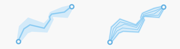

A corridor is an area that connects two locations and encompasses all possible cost paths below a specified accumulative cost. On the left is an example corridor (blue area) displayed with the optimal path (blue line). On the right is the corridor with all the possible cost paths whose values are less than the specified threshold.

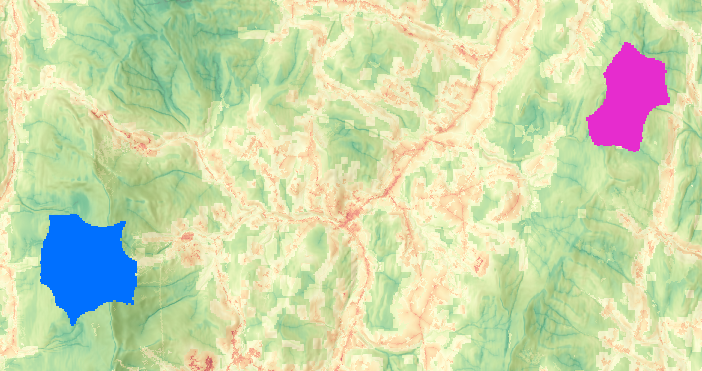

The two regions (blue and pink) to be connected using the identified cost surface. The cost surface values range from lower cost (green) to higher cost (red).
To obtain the inputs for the Least Cost Corridor tool, you will run the Distance Accumulation tool twice. Once for the blue region and once for the pink region. Use the same cost surface and analysis settings. The resulting outputs are an accumulative cost distance and a back direction raster for each region.

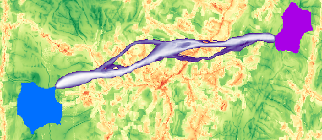

The final corridor between two locations, created using the Least Cost Corridor tool. Lower costs within the corridor are a white or lighter purple while higher costs are a darker purple.
In the final corridor raster, all cells with accumulative cost under the specified threshold are included. The cost is lowest towards the center of the corridor and increases as you move outward from the center. There are some thinner parts of the corridor that diverge from the main, thicker area of the corridor. These thinner parts are routing around higher cost areas and are included because they too are below the 1% threshold.
