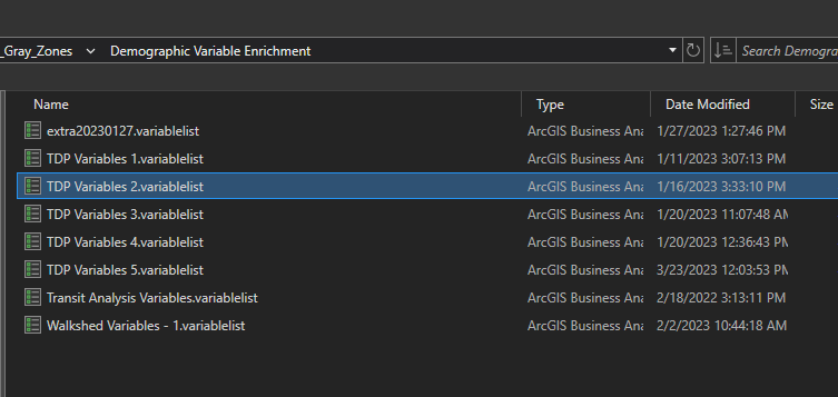

Ex. I moved all these into a project subfolder called "Demographic Variable Enrichment" using Win Explorer, and unlike layers in the TOC, clicking the little [!] doesn't even prompt me to change the source. There's no choice other than to remove them from the project and re-add them manually.
You also can't multiselect when adding them back in, nor do they appear in the catalog view's data source manager.
If you go navigate to the new location in the catalog view, you can multiselect there and add R click > Add to project; it would make more sense if this were consistent, though.

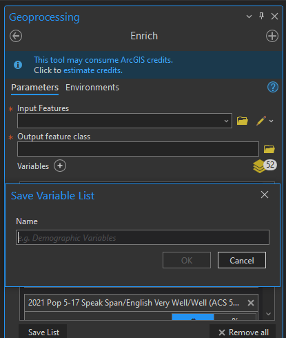

It would help if all of the above were easier; the biggest most "upstream" help would being able to specify the save location at this point:
Most other tools/features already prompt you to choose a location when saving something so this would be much more intuitive and useful. CA/BA just feels a little half-baked all around; these types of improvements matter. Thanks.
