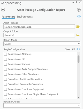

Generating a report
Now that we have a better understanding of the configuration table and how to work with it, you can run the Apply Asset Package or Asset Package to Geodatabase tool, check and uncheck the configuration entries (the alias of the column is displayed) and generate a Utility Network tailored to your needs. This process may take a while on a larger data model. We provide a tool that will generate an excel report very quickly to ensure the results are what you desire, before running the Asset Package toolset. The Asset Package Configuration Report geoprocessing tool in the Utility Network Data Management Support (UDMS) toolbox is a part of the Utility Network Foundation solution or available via github. Use this report to evaluate the output and verify it meets your organization’s needs.
The geoprocessing tool includes the following parameters:
- Asset Package – The Asset Package you wish to use to create the report from. It Package must contain a valid D_Configuration table.
- Output Folder – The Folder that the Configuration report folder will be created in.
- Report Mode – We recommend using Single for the Report Mode Parameter for a description of how to use the other parameters see the documentation.
The Asset Package Configuration Report tool creates a folder under the Output Folder named Configuration. If the folder already exists a new one is created with the next sequential number appended to the name. The output folder contains the Configuration folder with the following structure:
