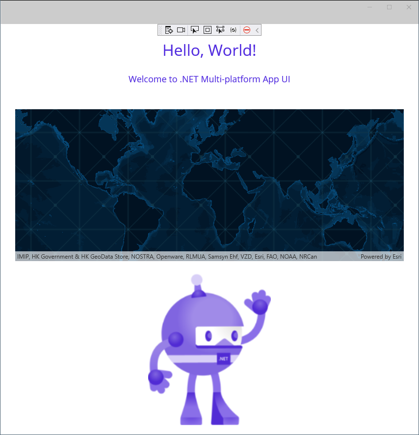

17. Now it's time to build and run your app. Below is an example from following the steps above and running on a Windows Machine.
