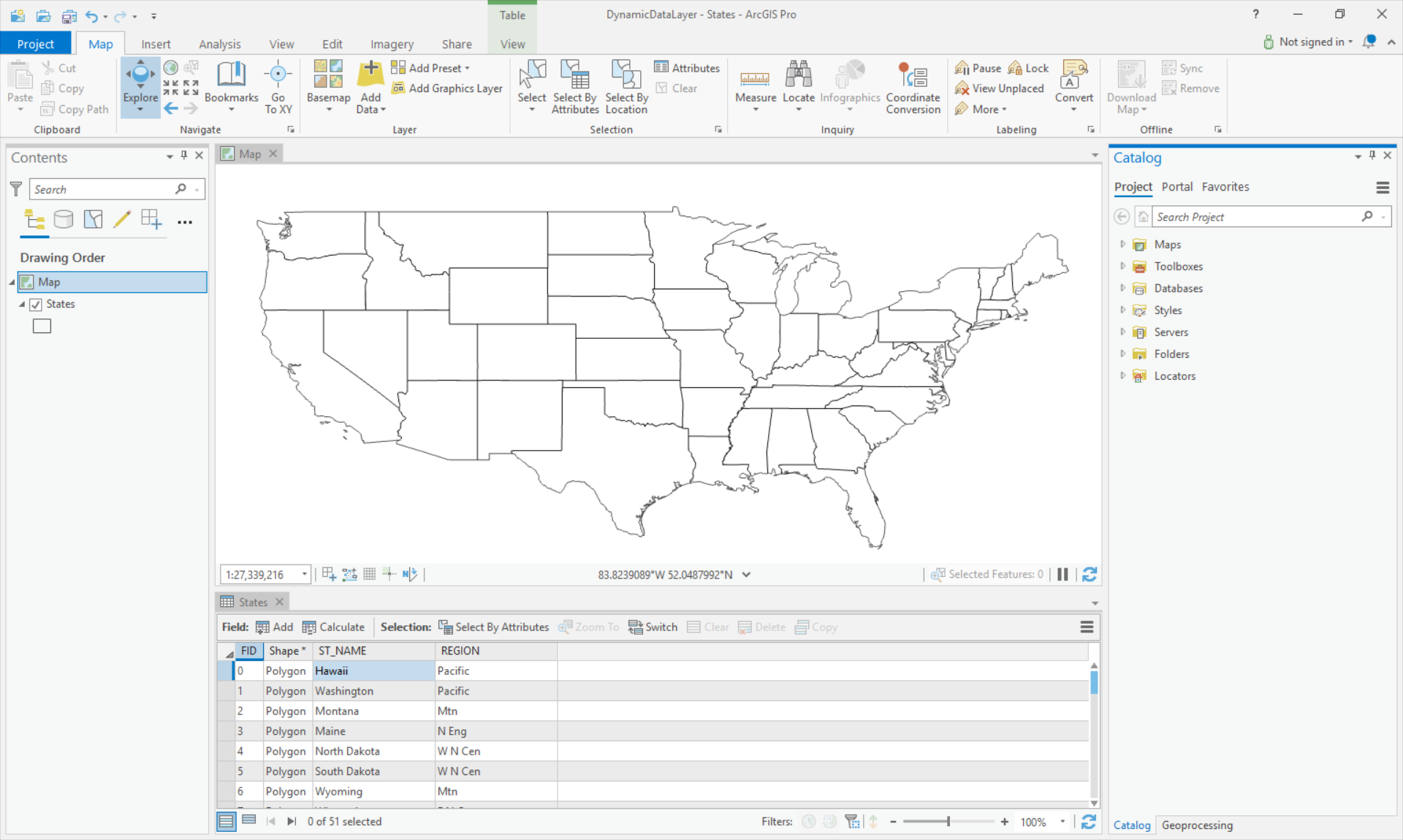

This blog post will show how to use ArcGIS Pro to author a shapefile containing private information. Then using the ArcGIS Server Manager, we will add this shapefile to an existing ArcGIS Server published map service, but with the caveat that this new dynamic layer can only be accessed when certain key pieces of information are known to the developer or end user of the app. Finally, using the WPF framework in the C# programming language, we'll create an ArcGIS Runtime application to consume the dynamic data layer. This app will be able to modify the rendering of the dynamic data layer on the fly, and perform identify operations to look at underlying attribute information.
ArcGIS Pro
Using ArcGIS Pro, I created a shapefile (named States.shp) based on the USA state boundaries. The attribute data contained the following fields for each USA county:
| FIELD NAME | TYPE | NOTES |
| FID | Object ID | Object ID for each record |
| ST_NAME | String | State name |
| REGION | String | Geographical region of the USA that contains multiple states |
For display purposes in ArcGIS Pro, I set the fill for the county boundaries to be transparent and the outline to be 0.5 pixels wide. However, it really does not matter how the shapefile is rendered in ArcGIS Pro, because the rendering is not preserved when added to an existing map service with the ArcGIS Server Manager, as we will see later.

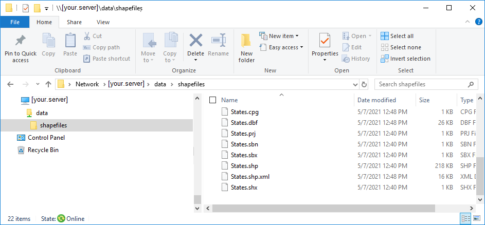

First, we want to copy the shapefile (States.shp and all of the other files with the same name but different file extensions) that was created in ArcGIS Pro to location that ArcGIS Server has read/write access to. In our case, we will copy the shapefile to the physical hard drive of the server, as depicted here:

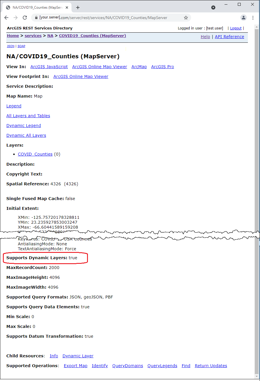

In my prior blog post: Creating and using 'dynamic map layers', we had a published map service (called COVID19_Counties (Map Server)) that had the Supports Dynamic Layers: true with the following configuration:

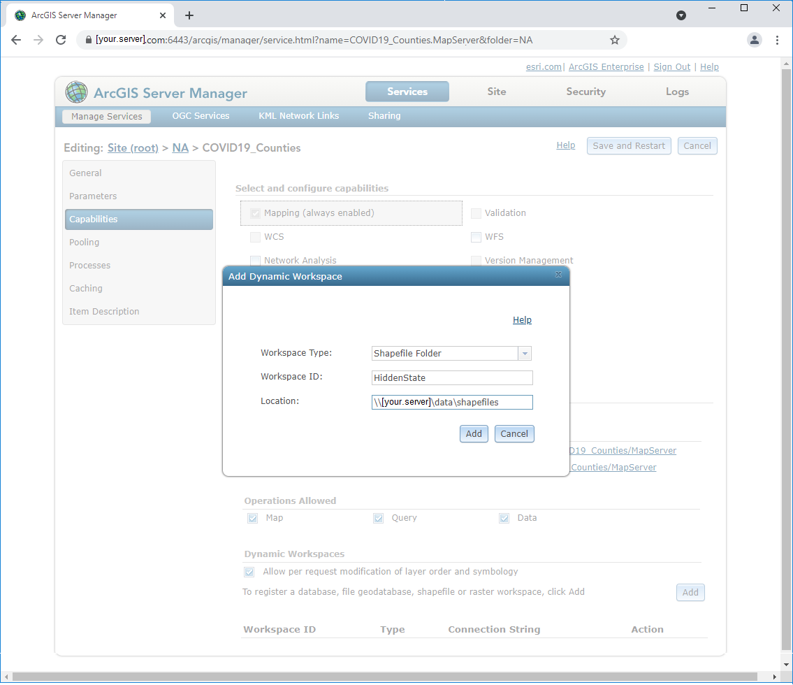

Next, click on the Capabilities tab. Then scroll towards bottom and click the Add button to register a database, file geodatabase, shapefile or raster workspace.
When the Add Dynamic Workspace dialog opens, specify the following options and click the Add button:
| Workspace Type | Shapefile Folder |
| Workspace ID | HiddenState |
| Location | [YourHardDriveFolderLocationOnArcGISServer] |
It is important that the Location string for the shapefile is the same place where you copied the shapefile from ArcGIS Pro onto the ArcGIS Server Machine.
NOTE: If you desire to use one of the other Workspace Types of: Enterprise Database, File Geodatabase, or Raster Folder, you can click the Help link in the Add Dynamic Workspace dialog to learn more about those options.

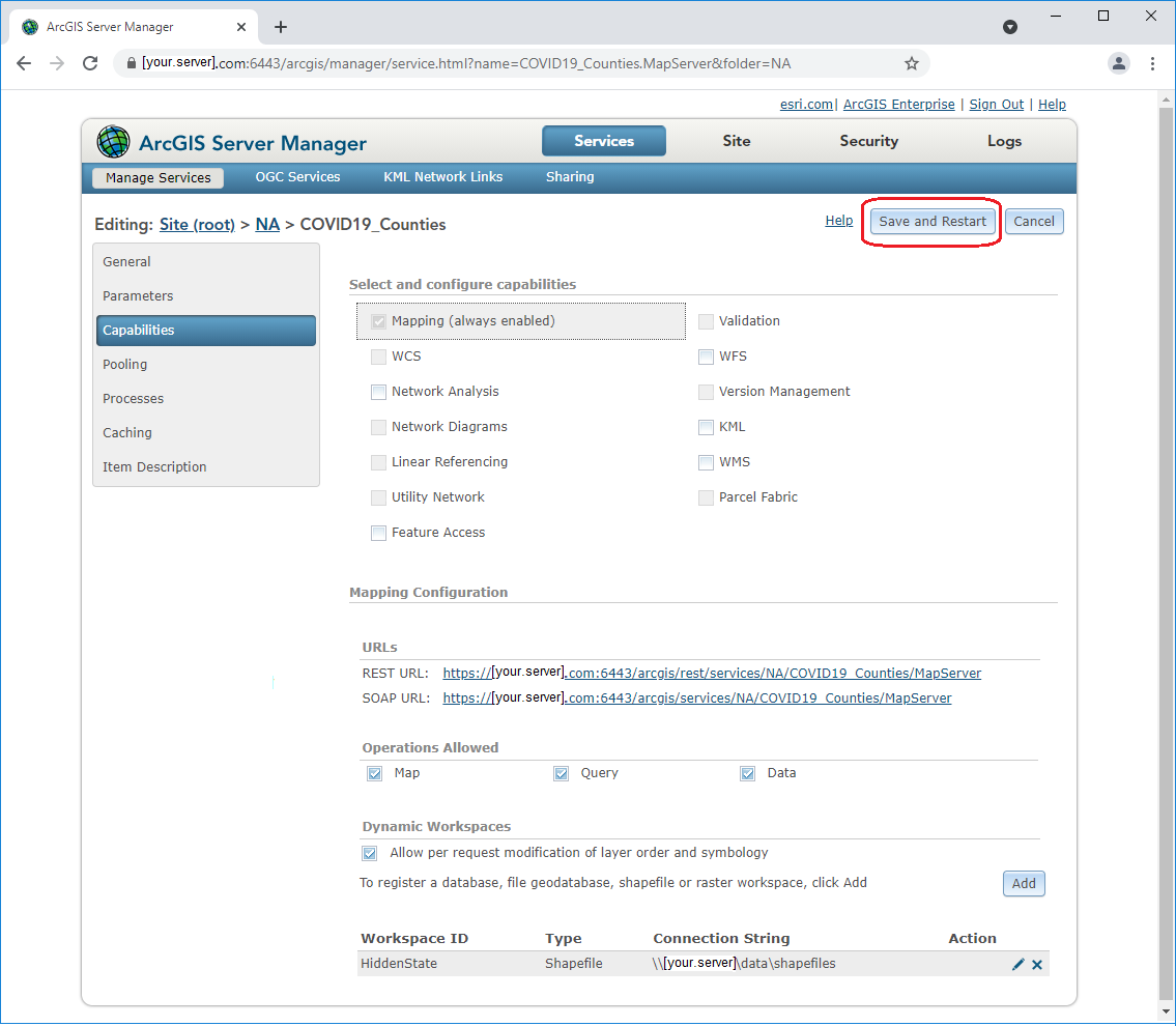

After the new dynamic workspace has been added, review the information to ensure it is correct, and then click the Save and Restart button for the new dynamic data layer to become in-effect for the map service.
We just registered our dynamic data layer with an existing ArcGIS Server map service. This act of registration enables direct access to the GIS data layer. There was no symbology rendering defined as when we authored and published the dynamic map layer with ArcGIS Pro (described in the previously blog article). This means that any rendering (like a SimpleRenderer, UniqueValueRenderer, etc.) must be defined by the developer when accessing this data in their app.
At this point, you will want to record two pieces of information required to access the shapefile based dynamic data layer from your client app. Without these two pieces of information, users cannot discover or access the dynamic data layer.
The first is the WorkspaceID to your shapefile. In our case this is the string "HiddenState". This will be used as the workspaceId parameter of the .NET Runtime Esri.ArcGISRutime.Mapping.TableSublayerSource object constructor. You can use any string you desire for the WorkspaceID; it just provides a unique name that only the author of the data and the user of the data know about.
The second is the DataSourceName for your shapefile. In our case, this is the string "States.shp" (which is the name of the shapefile with the .shp extension). This will be used as the dataSoureceName parameter of the .NET Runtime Esri.ArcGISRutime.Mapping.TableSublayerSource object constructor. TIP: When trying to figure out the DataSourceName for an Enterprise Database (or SDE), it usually follows the pattern: "[DatabaseName].[SchemaOwner].[FeatureClass]". Example "ss6.gdb.States".

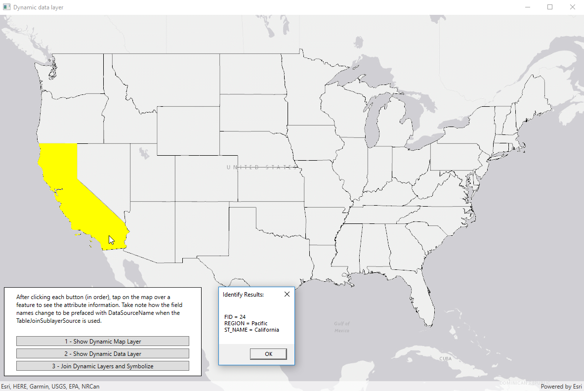

This file contains the main logic for the running of the app. There are 7 main sections worth discussing to provide insight on how the app works:
(1) The using statements at the top of the file shorten the syntax for writing the code.
(2) The IntializeMap() function sets up the initial look of the GUI. It adds the world light gray base map, zoomed to the area of the continental USA to provide orientation for the operational layers. A default GraphicsOverlay is created to aid in the identify process. Finally, the GeoViewTapped event is wired up to handle the user map taps, to obtain the identify results.
(3) The ResetLayers() function will clear out any graphics in the GraphicsOverlay from a prior identify operation, and clear out any prior operational layers that were created by adding dynamic layers.

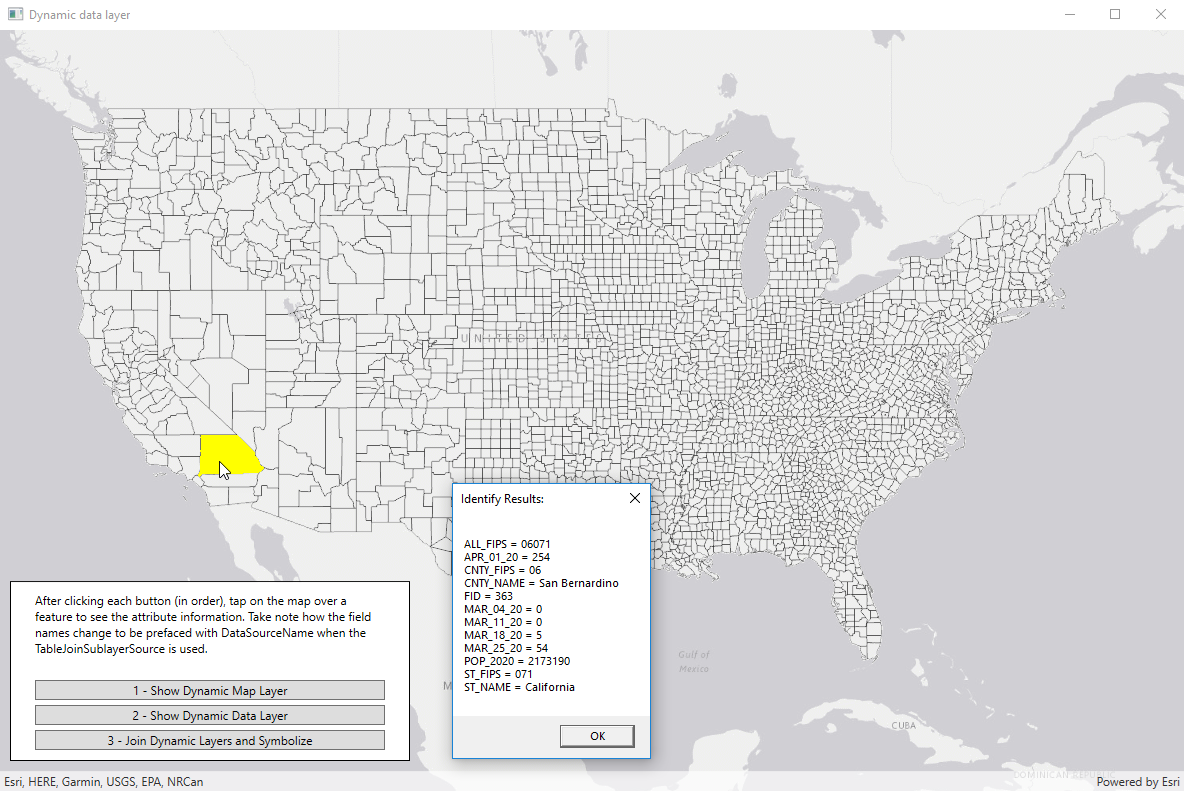

(4) The Button_DynamicMapLayer_Click() function adds a dynamic map layer to the application showing USA county COVID-19 cases. The default rendering of the layer comes from the published ArcGIS Server map service that was authored in a prior blog post. The dynamic map layer is created via the MapSubLayerSource object to create an ArcGISMapImageSubLayer object. The dynamic map layer is attached as an ArcGISSubLayer of the ArcGISMapImageLayer and added to the map.
(5) The Button_DynamicDataLayer_Click() function adds a dynamic data layer to the application showing the USA state boundaries. This is the layer that was created using the ArcGIS Server Manager and is only accessible when the WorkspaceID and DataSourceName strings are known to the developer or user of the app. The dynamic data layer rendering must be specified by the developer in the app; in our case we use a SimpleRenderer based on a SimpleFillSymbol. The dynamic data layer is created via the TableSubLayerSource object in order to create an ArcGISMapImageLayer. The dynamic data layer is attached as an ArcGISSubLayer of the ArcGISMapImageLayer and added to the map.

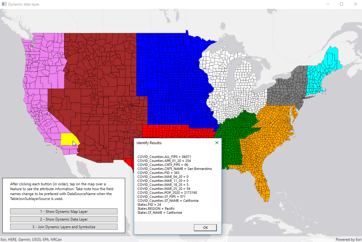

(6) The Button_JoinDynamicLayers_Click() function creates a dynamic layer based on the TableJoinSublayerSource object. The TableJoinSublayerSource takes any two abstract SubLayerSource objects and joins them together based a common field in the attributes. In our case, we will join together the USA counties layer using a MapSubLayerSource, and the USA states layer using a TableSubLayerSource as the abstract SubLayerSource types. The common field to join the two dynamic layers is the state name (ST_NAME). To make things visually appealing, a UniqueValueRender was used to show which counties belong to a particular region of the USA. I used the term dynamic layer in the generic sense for this function; think of it as a hybrid of information coming from a dynamic map layer and a dynamic data layer.
(7) The MyMapView_GeoViewTapped() function provides attribute information on the dynamic layers in the map where the user taps. The existing GraphicsOverlay is obtained and cleared from previous user interaction. Using the IdentifyLayersAsync method, the IdentifyLayerResult object is returned and SubLayerResults are obtained. While iterating over the results, the GeoElement is obtained and used to construct a yellow solid fill. It is then added to the GraphicsOverlay. Additionally while iterating over the results, the attribute information is obtained. By iterating over the Attributes the Key/Value pairs for each identified county, the results are present back to the user in a MessageBox.

TextBlockInstructions.Text = "After clicking each button (in order), tap on the map over a feature to see" +
" the attribute information. Take note how the field names change to be prefaced with DataSourceName" +
" when the TableJoinSublayerSource is used.";

After the code complied without any errors, it was time to test out the app. When the app opens, it shows the basemap layer of the world light gray base, zoomed into the continental USA.
First, let's click the 1 - Show Dynamic Map Layer button. This will add a USA counties dynamic map layer based on the ArcGIS Server published map service. Then, tap on any county to see the attribute information display for that record.
Second, click the 2 - Show Dynamic Data Layer button. This adds a USA states dynamic data layer based private registered dataset using ArcGIS Server Manager for the ArcGIS Server published map service. Then, tap on any state to see the attribute information display for that record.
Third, click the 3 - Join Dynamic Layers and Symbolize button. This adds a dynamic layer to the map that is a hybrid of a dynamic map layer and a dynamic data layer. The map shows the USA counties layer that has the attribute information from the USA states layer joined to it. Tap on any county to see the attribute information and you will find the attributes are display from both data sets. The layer will use a unique value renderer to show the counties by the region of the USA they belong to. Notice the identify results MessageBox to see that the name of the fields are prepended with which data layer the attribute belongs to. This shows the power of a spatial join, and accessing information that you want to keep private.
