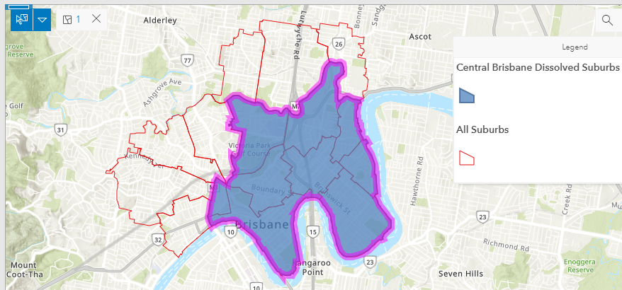

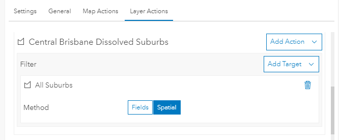

Pic 1 - Map element - Layer action with spatial filter method
The selecting layer is a by-product (dissolve) of the layer being selected, so is a perfect match to the boundaries.
Pic 2 - the neighbouring suburbs are selected, presumably because they touch.

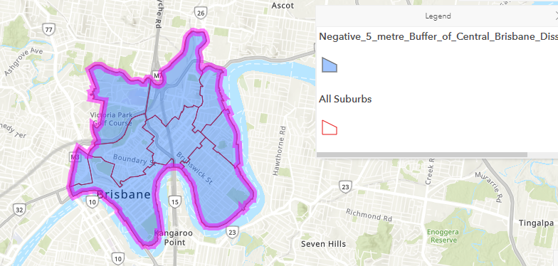

Pic 3 - configure workaround using a negative buffer of the selecting features
Pic 4 - result with the workaround in place
