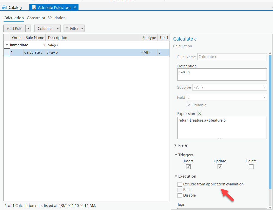

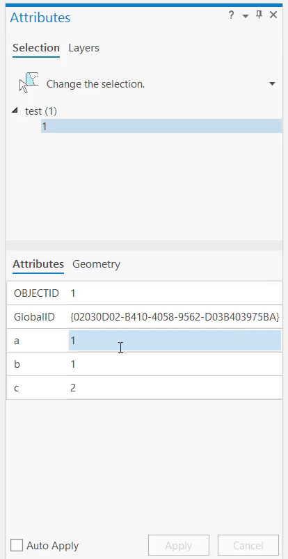

You can see this behavior in Pro's attribute pane window while the Auto Apply option is turned off. Here is an example where we have an attribute rule that adds field a to field b and store the value in field c. The rule has allowed for application evaluation.
Exclude from Application Evaluation
When unchecked, "Exclude from Application Evaluation" property tells the application that its "safe" to execute this rule locally before sending the edit request to the backend. So you get the behavior like the attribute pane in place execution without the need to persist your edit to the backend to see the rules effects. Smart applications can look at this property and decide to leverage local attribute rule execution if it supports it. As for the time writing this blog, ArcGIS Pro is the only application that is capable of executing attribute rules locally.

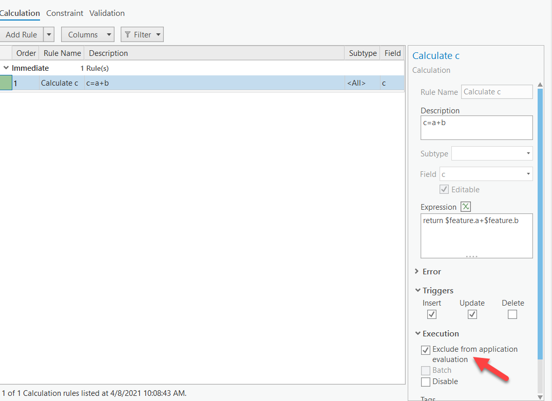

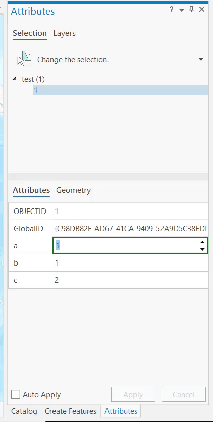

Here is the same rule from before but with Exclude from Application Evaluation turned on. Noticed that local edits in the pane does not trigger the attribute rule until applying the edit to the workspace.
