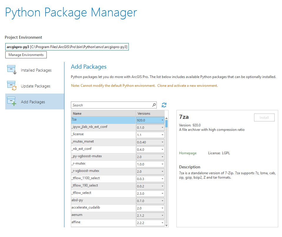

Would be even better if we could create our own python conda packages and import them directly to ArcGIS Pro, using the existing ArcGIS Pro's built-in conda package manger.
As a developer, yes I can. But many of our end users are not familiar with command prompts and the main purpose of this idea is allow end users to add any python package they want. Since ArcGIS Pro is intended to be used for non-developer users, I think would be nice if Esri improves the Conda package manager user interface in Pro to add custom packages.

Exacly. And the purpose of this idea is about make the package manager functional, flexible and user friendly, once many users who want to install a package would not be familiar with command prompts.

conda install whatever --dry-run - doesn't exist in the package manager, sure prevents an install that might go bad
conda list - always seems out of date, even when you update via conda, it still refuses to reveal all.
And it is brutally slow for some reason. Compare an parallel install via conda and the package manager on two machines... students are now using conda
Dan Patterson, actually the suggestion is about add custom python packages using the ArcGIS Pro's Conda interface, it is not about managing python environments with Conda.
As a developer, you may want to create and distribuite along the corporation your own python package. The preferred way is to build a wheel file (An Overview of Packaging for Python — Python Packaging User Guide ). So, 'the feature request' is the ability to import a wheel file using the Conda interface built in ArcGIS Pro - realize that currently ArcGIS Pro only allows install pyathon packages listed in conda's public directory. Hope the idea is more precise now.
