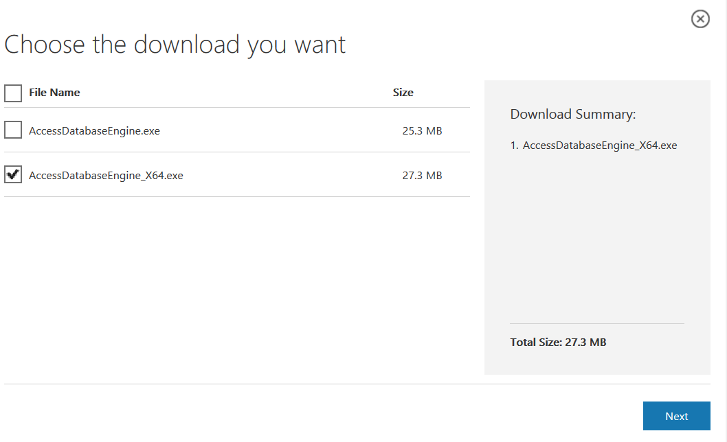

You will need a machine that has the 64 driver installed so you can create the fgdb from the access files. I was able to get 64 bit access driver on my machine with 32 bit office by first installing the 64 bit driver and then office.
I have noticed the CCTV Processor is being replaced with CCTV Manager. The 64-bit Microsoft Access Database Engine is now a requirement for these tools to work. Will ESRI still provide a workaround for those of us who are still running the 32-bit version?

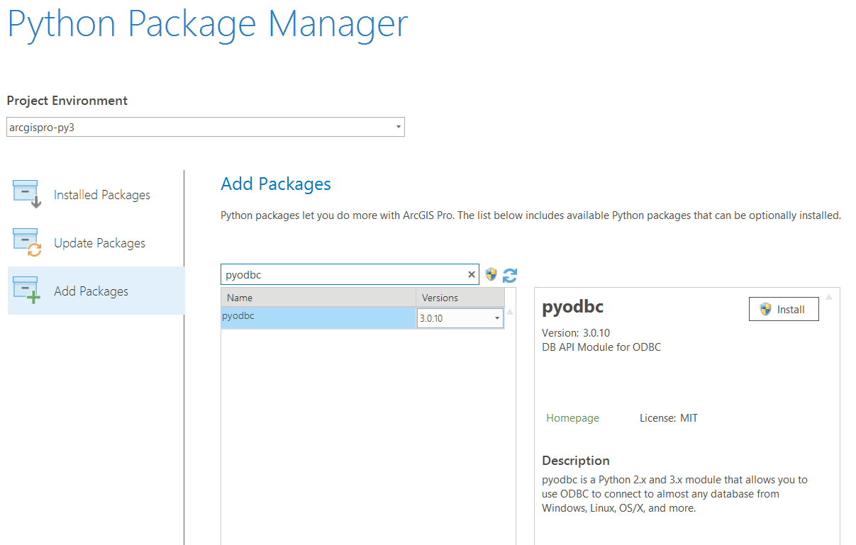

I'm working on a version that will read the CCTV data from a file geodatabase. There will be a separate tool (which still requires pyodbc), to convert Access to FGDB.
I am running into the same issue as Tristan because my version of Office is 32bit. Is there any way to get this new version of CCTV Processor to work for those of us who can't install the 64bit version of Office?

What version of Office do you have installed? I have x86 Office 365, and I can install and use x64 Access driver without issue.
I have Microsoft Office Suite 32bit and Access 32bit installed. If I try to install the Microsoft Access Database Engine 2010 Redistributable(64bit) I get an error "You cannot install the 64-bit version of Microsoft Access Database Engine 2010 because you currently have 32-bit Office Products installed"
If I force the install using the /passive command prompt command it "installs" however when try to run the CCTV processor I get the following error, "Unable to load odbcji32.dll"
If I remove Office and Access and then install Microsoft Access Database Engine 2010 (64bit) the CCTV processor works but I don't have Office suite or Access now.
If I attempt to reinstall Office and Access 32bit, I get the following error "You cannot install the 32-bit version of Microsoft Office Suite because you currently have 64-bit Microsoft Access Database Engine 2010 installed"
This is a bit of a Catch 22
Is there a correct installation practice for Office 32bit and Access 32bit along with getting the CCTV processor to work other than installing the 64bit version of Office?

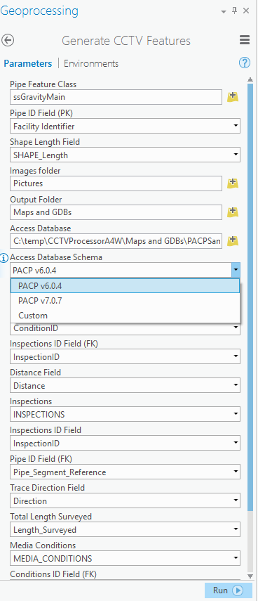

That solved the problem. I just needed to modify the table names in the original survey database. Thank you very much Paul!!!
Does your sample database match the PACP schema? It's looking for 'inspections' and your PACP database table is called 'pacp_inspections'.
You can either rename your table to be 'inspections' (case doesn't matter) or modify the schema to use your table name of 'pacp_inspections'
CCTVProcessorA4W\Maps and GDBs\cctv\schema\PACP v6.0.4\schema.xml
Ok yea that fixed the initial error. I should have caught that but thank you Paul!
I'm running into another error though. Sorry, I'm not sure how to look through the script and debug it myself. I think there is any issue with the save_to_disk function. Not sure why I'm getting this error with my own database and not the sample.

Are you using a PACP v7 schema? The code is incorrectly guessing that 'Direction' is the Inspections ID field. If you change that 'InspectionID' or similar, it should work.

That library is required to use the tool. That is why you are getting the !
Python toolbox is not loading for me. I talked with my IT Dept about downloading that Access Database Engine x 64-bit because I am thinking this is my issue. They informed me not to do this as we are running 32 bit. Is there a work around for this? I cannot tell if I am experiencing another issue since I am unable to download the 64 bit Access Database Engine.

At the moment, only an access database is support as an input type. Is your data in an Access Format? If so, select custom and then fill out the parameters. As for how to get a custom item in the drop down, we have not typed those instructions up.
Paul93
... I'm expecting instructions for the Custom format (I saw it ask for Access database, but by default the data are in XML) now ..

* Mine is not loading as I do not have ODBC install
