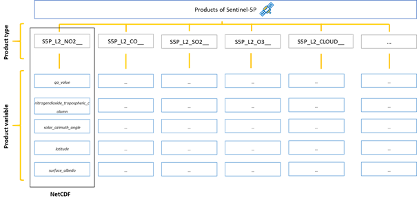

Sentinel-5P is a satellite that is operating within ESA's Copernicus program since 2017. The goal of the mission is a very dense scheduled operational monitoring of the atmosphere. Using the TROPOMI instrument on board, various parameters are measured, such as tropospheric pollutants, greenhouse gases, aerosols, and cloud cover. NO2 concentrations are also provided as a separate product, which can be downloaded as NetCDF. More information about this product can be found in the ESA user manual.
Figure 1: Data structure of the Sentinel 5P products

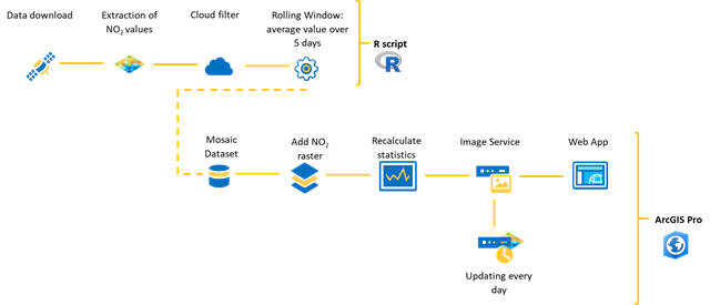

Figure 2: Workflow to create an automated time series analysis based on Sentinel-5P data
The figure above shows the schematic workflow where an R script is used to download Sentinel-5P data from the Copernicus-Hub, extract the corresponding NO2 product variable and export the scenes (filtered and clipped) as GeoTiff.
Afterwards a mosaic dataset is created in ArcGIS Pro, which contains the resulting NO2 GeoTiff files. The Mosaic can be published as Image Service.

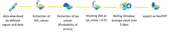

Figure 3: Workflow R script
With the help of the R package GetSpatialData various satellite data available on the Copernicus Open Access Hub can be downloaded automatically. Conditions like recording period, satellite, product type and area of interest can be defined. NO2 data is stored in the Sentinel-5P product type L2__NO2___, therefore only this data is of interest and should be downloaded for the desired period.
The subsequently downloaded NetCDF files contain several variables, such as longitude and latitude, different viewing angels and various nitrogen dioxide related variables. Product variable 6 (nitrogendioxide_tropospheric_column) displays the NO2 concentration in the troposphere, which is used for the following analysis. Using the S5Processor package, this variable can be queried and saved as GeoTiff. In addition, cloud masking is applied to prevent outliers. Product variable qa_value indicates the error probability of the measured values (e.g. due to cloud cover or snow). By blending the two variables and the resulting elimination of errors (qa_value < 0.5 = NoData) a corrected nitrogen dioxide layer is obtained (unit molecules/cm²).

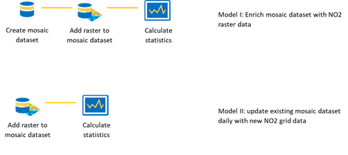

Figure 4: Workflow ModelBuilder (export as Python script)
After all data has been transformed and edited, the workflow is continued in ArcGIS Pro.
ArcGIS Pro makes it easy to create an automated workflow within the ModelBuilder that performs spatial analysis using the appropriate geoprocessing tools.
In this case a mosaic dataset is created and enriched daily with the newly exported NO2 GeoTiff files. The fact that the raster data is dated means that it can automatically be arranged chronologically. With latest addition to ArcGIS Pro (2.5 and later) this Mosaic can be declared a Multidimensional dataset and thus allow the Multidimensional tools (aggregation, change detection, trending, etc.) to be applied.
The mosaic dataset can also be published as an image service using ArcGIS Server.
Once the scripts are set up, they can be run automatically every day, for example, using the Windows Task Scheduler.
