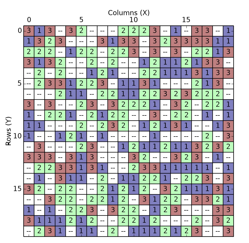

The attached pdf will serve for now. I will add additional documentation here on how to work with rasters with nodata areas here soon.
A simple example here, using Matplotlib to do the mapping. The -- cells are nodata values
| Raster/array values | Sample properties |
>>> print(c.filled()) # -9 is nodata
[[ 3 1 3 -9 3 2 -9 -9 -9 2 2 2 3 -9 1 -9 3 3 -9 1]
[ 1 3 2 3 -9 -9 -9 3 1 3 3 -9 3 2 3 3 3 3 1 1]
[ 2 2 2 -9 1 2 2 -9 2 2 3 -9 3 -9 3 -9 2 2 1 3]
[ 3 1 3 2 -9 -9 2 -9 2 -9 -9 1 2 1 1 2 1 3 3 -9]
[-9 2 -9 2 -9 -9 1 2 1 -9 -9 2 2 1 1 1 3 1 3 3]
[-9 2 3 3 1 2 2 3 -9 1 1 3 1 -9 -9 -9 2 1 3 -9]
[-9 -9 -9 2 1 1 -9 2 2 1 1 2 2 3 2 3 2 2 2 -9]
[ 3 -9 3 -9 -9 2 3 -9 3 2 2 2 1 -9 3 2 -9 2 2 1]
[ 1 -9 2 2 1 -9 2 1 2 2 -9 -9 3 -9 2 2 -9 1 -9 1]
[ 1 1 -9 -9 -9 2 -9 2 3 2 -9 1 2 1 3 1 -9 -9 1 3]
[ 1 -9 -9 1 2 1 -9 1 -9 -9 -9 -9 1 -9 -9 -9 -9 2 -9 3]
[-9 3 -9 -9 -9 2 3 -9 -9 1 2 1 1 2 1 1 3 2 3 2]
[ 3 3 3 -9 3 1 3 -9 -9 -9 3 2 -9 -9 3 2 3 -9 1 -9]
[-9 2 2 3 3 1 3 1 -9 -9 2 3 3 1 1 1 1 1 -9 1]
[-9 1 -9 3 1 1 -9 2 -9 1 1 2 2 1 -9 2 2 3 -9 3]
[ 3 2 -9 2 2 -9 -9 2 1 2 1 2 -9 3 2 1 1 1 3 1]
[-9 -9 3 2 2 -9 2 2 1 2 -9 3 1 2 2 -9 3 3 2 1]
[ 1 -9 1 -9 2 2 3 -9 3 2 2 -9 1 2 3 -9 -9 -9 3 3]
[ 3 1 1 1 2 1 2 -9 -9 2 2 1 2 -9 -9 -9 2 -9 3 2]
[-9 2 3 1 -9 1 1 -9 2 -9 1 1 1 2 1 2 3 -9 -9 3]] | >>> c.mean() 1.96028880866426 >>> c.min() = 1 >>> c.max() = 3 >>> np.histogram(c, bins=[1,2,3,4]) (array([ 92, 104, 81]), array([1, 2, 3, 4])) |
