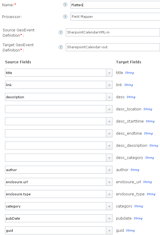

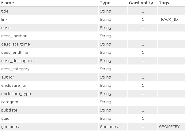

- I created a copy of this definition and flattened it to look like the following

- After the input add a 'Field Mapper' processor to map from your input definition to the flattened definition

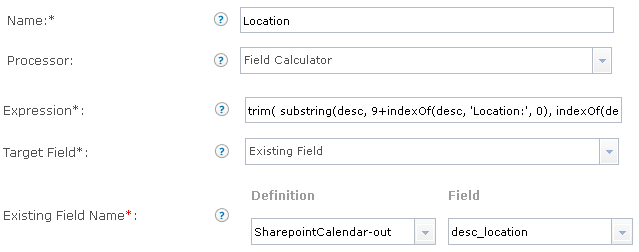

- Calculate the location
- Expression = trim( substring(desc, 9+indexOf(desc, 'Location:', 0), indexOf(desc, 'Start Time:', 0) ) )

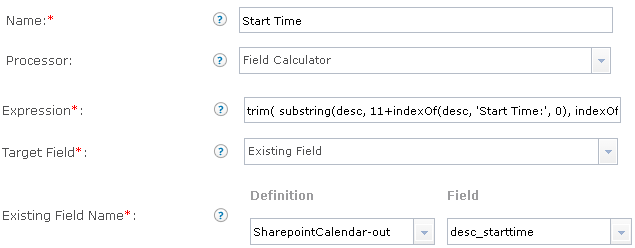

- Calculate the Start Time
- Expression = trim( substring(desc, 11+indexOf(desc, 'Start Time:', 0), indexOf(desc, 'End Time:', 0) ) )

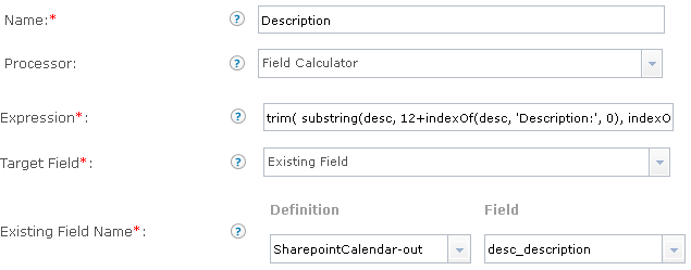

- Caculate the Description
- Expression = trim( substring(desc, 12+indexOf(desc, 'Description:', 0), indexOf(desc, 'Category:', 0) ) )
